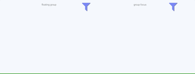

I couldnāt find the problem with the group focus. Is it not showing up at all?
I changed it to a floating group and itās working. A floating group is not ideal but it will do.
Here is whatās going on.

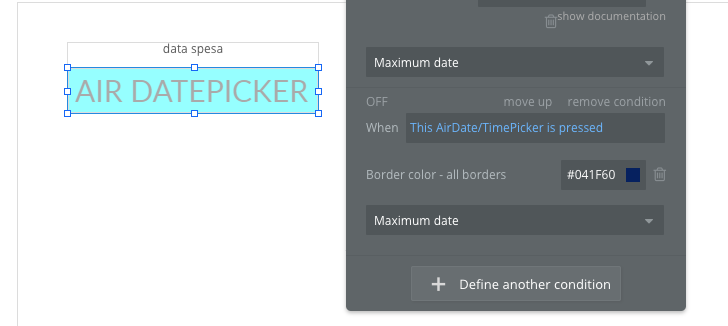

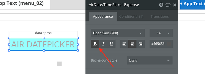

Hi @seanhoots, I have a question for you. I am using your super useful plugin but I think there is an issue with the style format. Let me try to explain with a couple of screen shots.
In the standard formatting we can change font type, font size or even font color. But there is no way, apparently, to change font to bold (also no difference between an Open Sans 600 and 700 or more).
This means that the selected date results in a different format with respect to normal standard input. As you can see, I would like to have the ā30 Marzo, 2020ā being bold like the currency input āEURā .
Is it possibile to achieve this result ? Thanks
*** ADDITION ***
There is another thing that it seems a little odd. If you set a condition like āwhen this date picker is pressedā the calendar does not show up anymore. While if the condition is āwhen this date picker is hoveredā the calendar shows up but as soon as the mouse is move outside the input cell it disappears. Thank you for your reply.

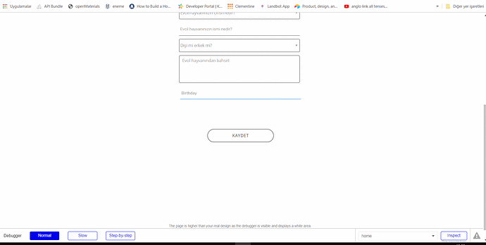

However, after testing it last night, I first ran into an issue where it would randomly go unresponsive, and itās not clickable. After deleting it and creating a new on, it worked. Then a few hours later the plug in completely broke and would only display a text input field instead, I tried it on several devices and browsers, all the same.
9 hours later it has magically started displaying as a date selector again, but is completely unresponsive and not clickable.

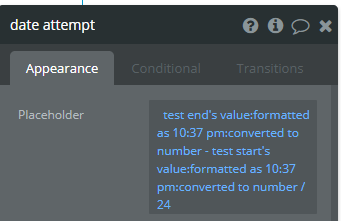

I am following your method to get the total number of HH:MM to get the event duration.
I am following this method used in spread sheets: how to calculate the difference in time in excel - Google Search
But the problem is that bubble will only subtract in a number and not a date - I am then finding it hard to convert them back to HH:MM.
I have saved the date in a number format:
Is this what you meant?
