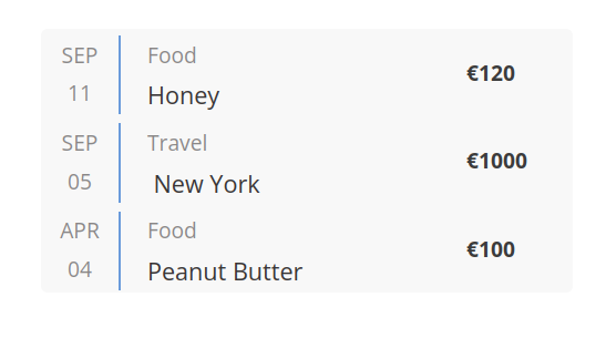

You can group all the elements of your cell & apply row gap
Screenshot 2022-09-15 at 17.38.21
Yes, we create a group in our repeating groups and then have a style for this type of groups so that we are consistent in how this is implemented.
Love the date format at the beginning of each row!
Thanks @treb.gatte :slight_smile: credit goes here
Thanks a lot @viquarahmed07 ! :slight_smile:
