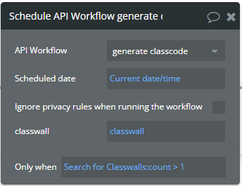

AND, here’s a way to do the same thing @mikeloc did, but in the page…
There’s no “real” reason you couldn’t do this kind of recursion in the page using Custom Events (assuming that the privacy rules allow the page to see all Classes and their Class Code field), except that Bubble prohibits custom events from directly or indirectly calling themselves.
Of course, you won’t be surprised we could work around that with List Shifter if we wanted to do it in the page. The basic technique is to use List Shifter’s Custom Value (which is like a custom state, but also can fire an event when it’s updated) to hold the generated “class code”.
Here’s how to set up List Shifter (I used number in my example, but as I said these should probably be strings):
And then also set List Shifter’s Process Output Type (which also controls the type of the Custom Value) to number as well, lower down in the main property inspector:
Create a Custom Event that represents the Class Code generation:
you’ll note I included a parameter for the list of existing Class Codes to make this simpler
And then the workflow for this event simply:
set List Shifter’s Custom Value to the generated class code, make sure that the Publish and Trigger Event options are set to yes
And now set up 2 workflows - 1 to handle the case where the Class Code did not collide, and one to handle the case where the generated Class Code already exists:
Here’s the collision case:
And the workflow is just trigger Generate Classcode again:
Here’s the non-collision case:
And the workflow for that case is just now create (or in practice, perhaps modify) our Class using our Class Code:
And there ya go - in-page recursive workflows with List Shifter.
