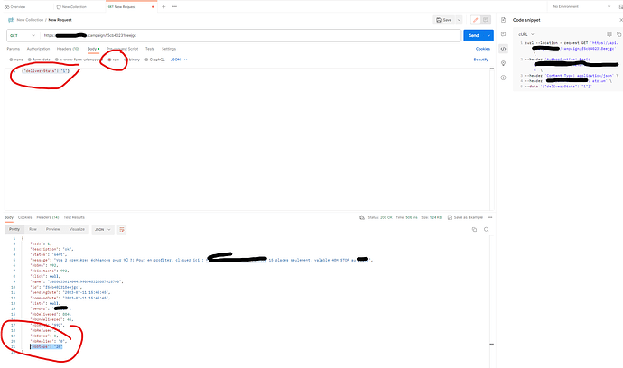

With postman, I can setup like this and have additional infos (like "“nbStops”: “26"” see below) :
But in Bubble, when I’m adding the “deliveryStats” as a parameter, I can’t get extra infos like nbStops etc…
Do I miss somethin ?

@Sarah_Esteve , in PostMan, could ou try to make the GET inserting your parameters in the PARAMS tab instead of in the body/raw?
yes I did, and same that in Bubble, no extra info like this

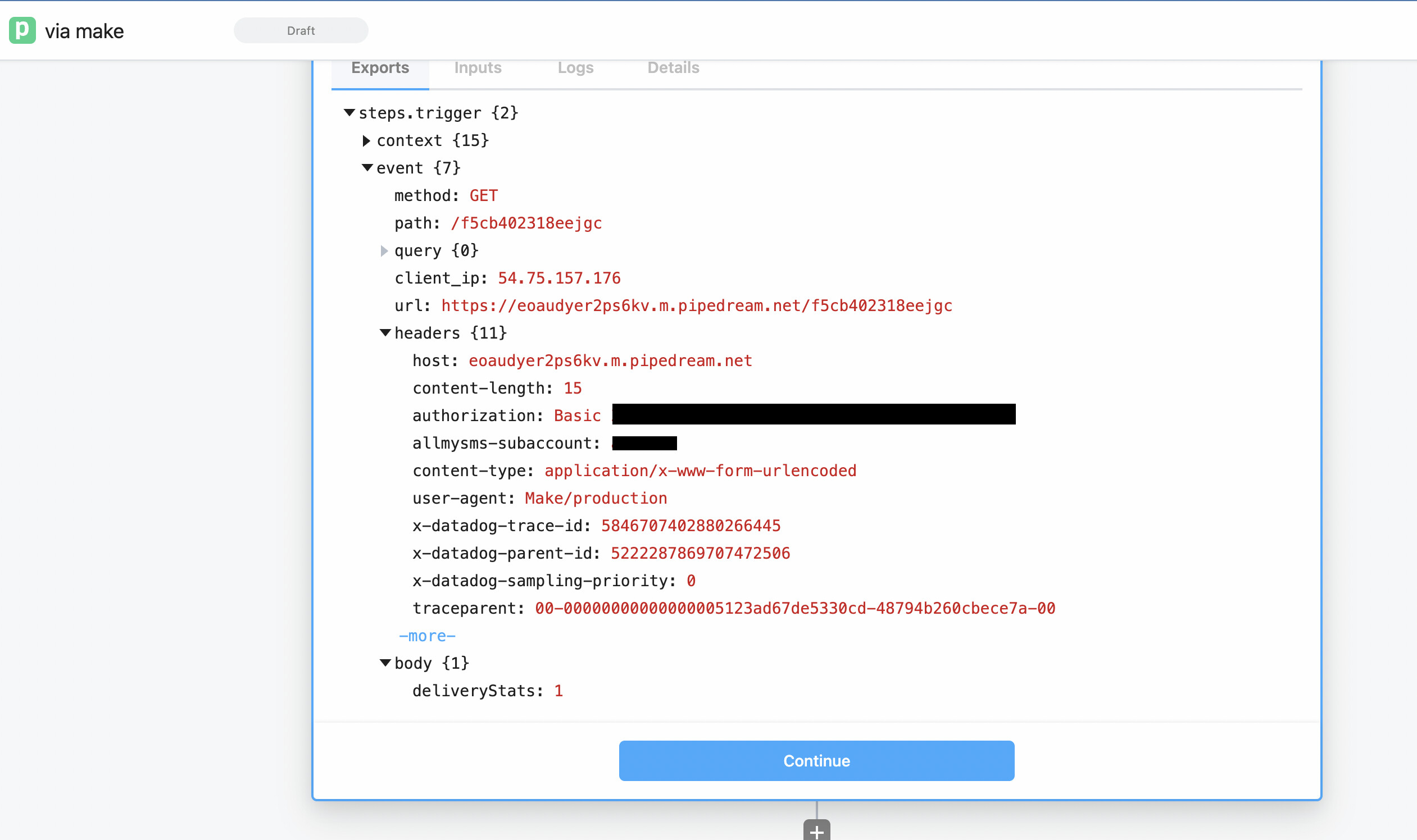

Can you share the input result part with headers and body?

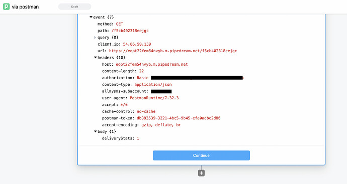

You can always send the request to requestbin.com from postman and make and compare both results.
thanks !

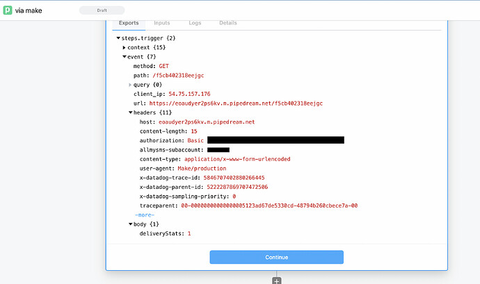

I tried in requestbin and seems the config is different…

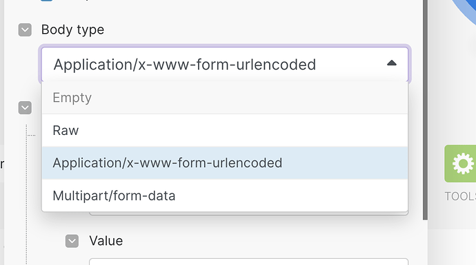

I cannot setup application/json in Make like in postman…
I don’t know how to handle this
I tried 3 ones but no worked
and if I put a query string parameter it doesnt appears in the body
