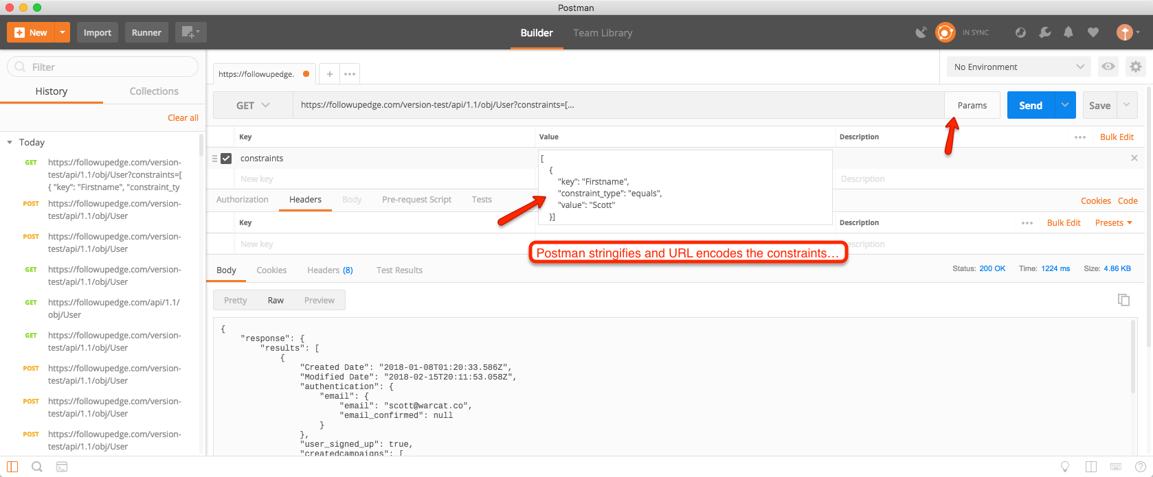

So, here’s an example of getting a User based on a set of search criteria. In this case, I wanted a user, in my test version, with the first name of “Scott”
Way #1
A few things to note:
  1. Ensure your app is exposing a Data API
  2. Click on the ‘Params’ button in Postman to expose the Key Value area, where you put in your Key/Constraint_type/Value as shown in the reference: Introduction - Bubble Docs
If you get it working in Postman, you should be able to structure things the way you want.

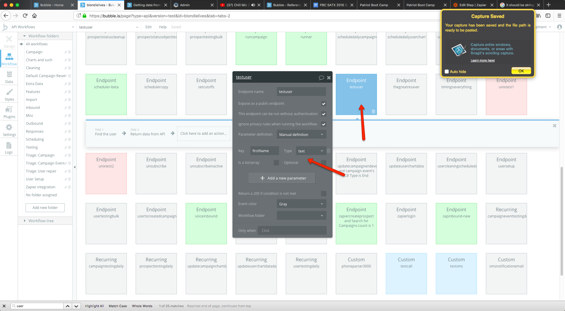

Another way to skin this cat:
Use an API Call to your app that returns Data
Way # 2
STEP 1 (setting up the WF parameters to take whatever you’re searching for)

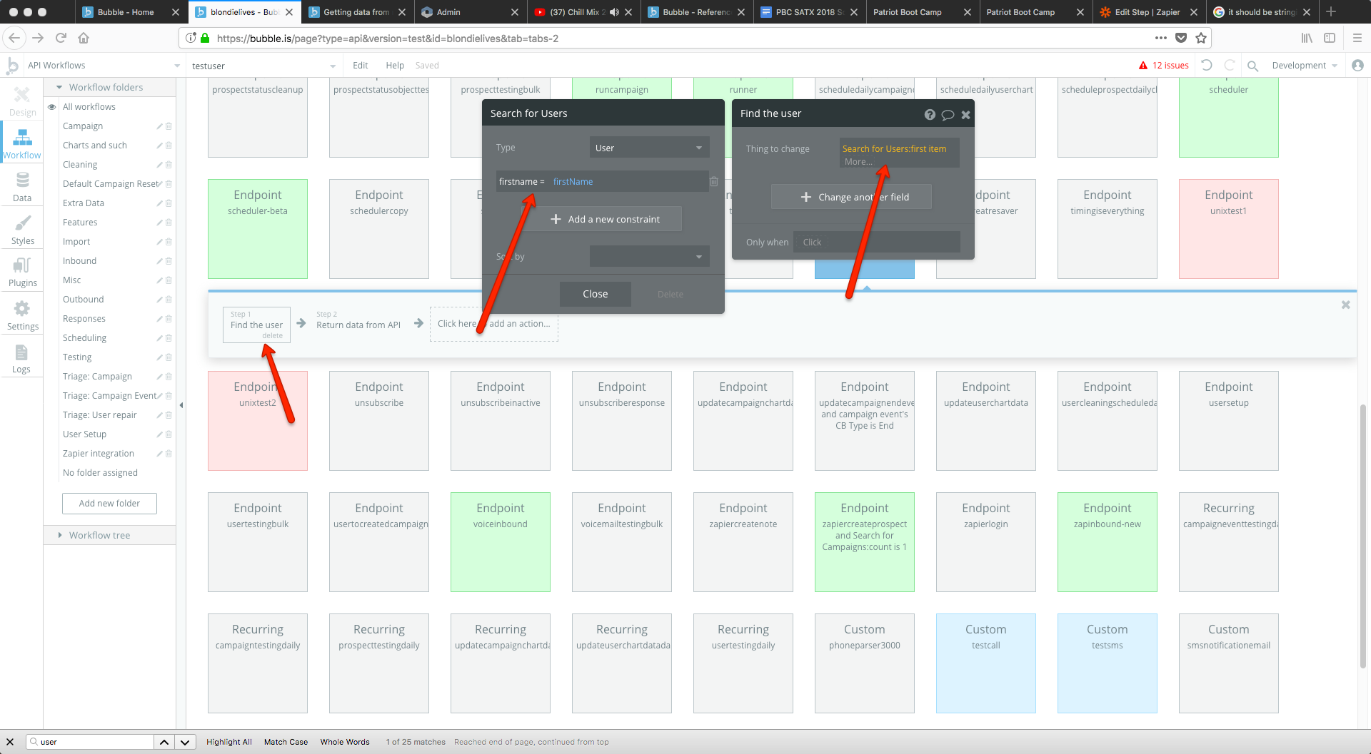

STEP 2 (Finding the user)

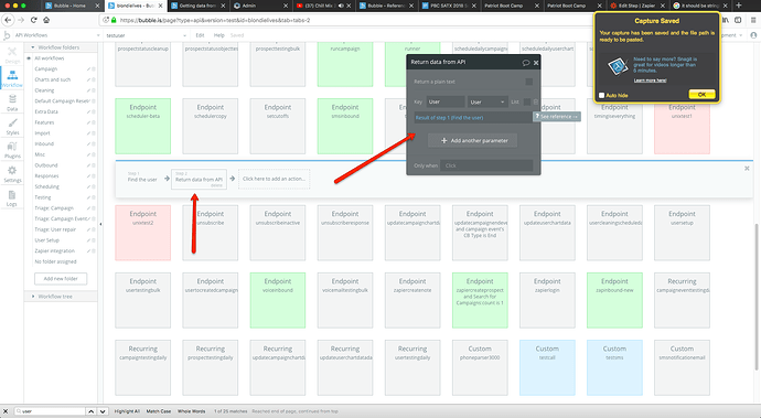

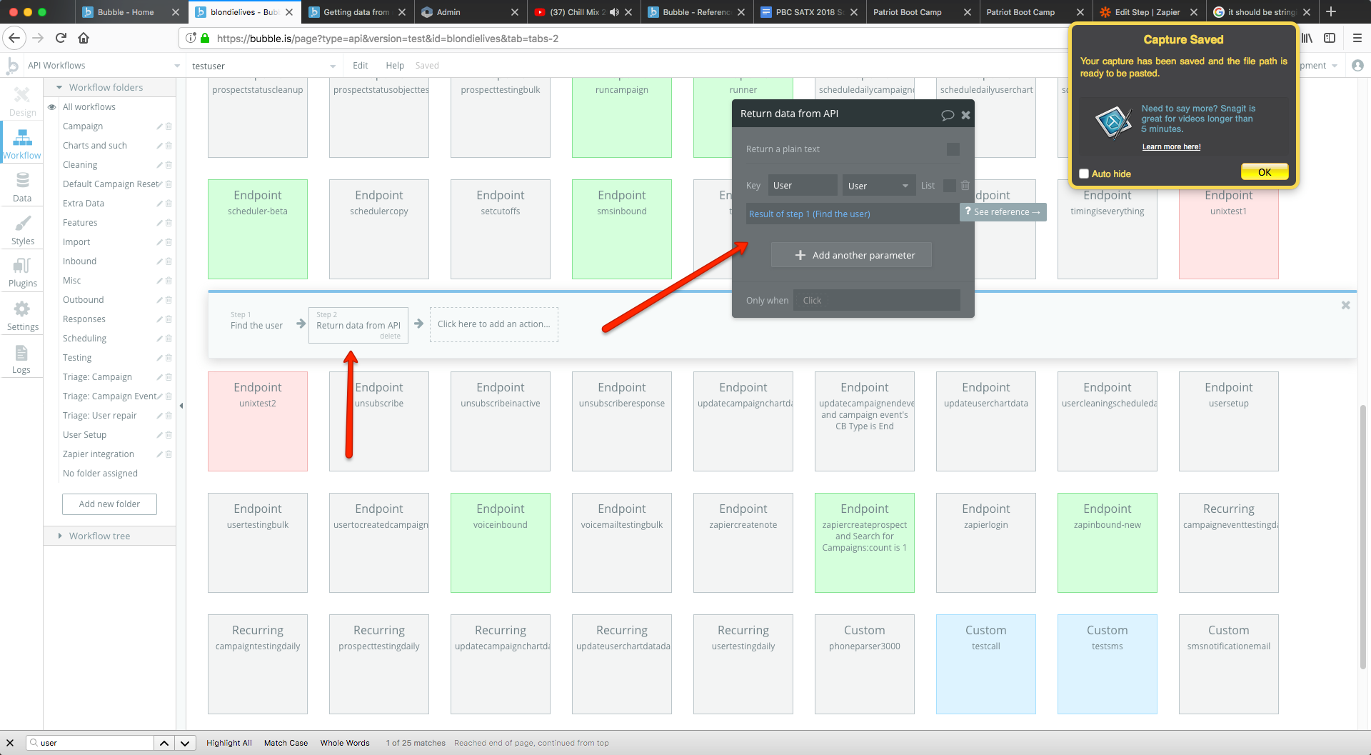

STEP 3 (returning the data from the API in the workflow)

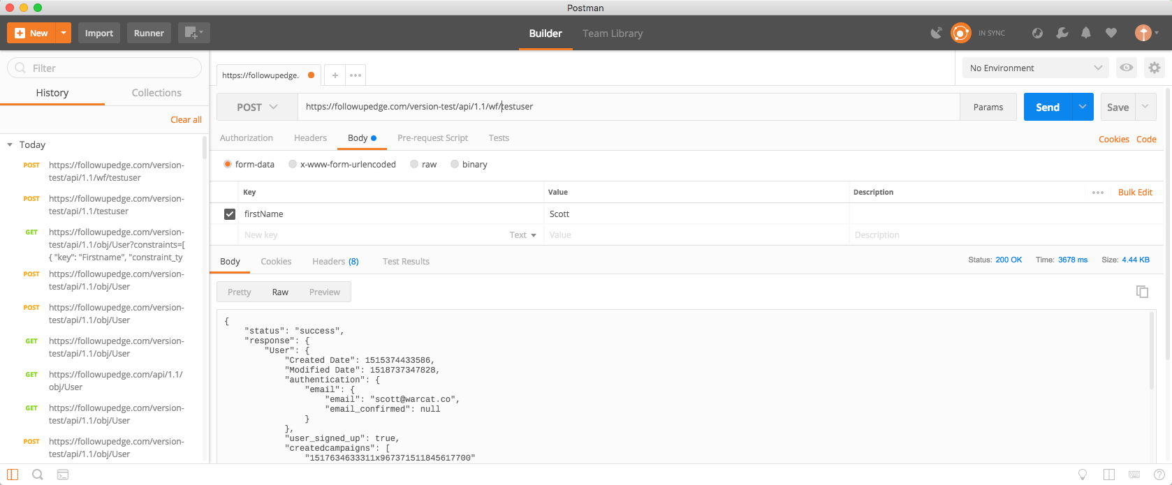

STEP 4 (postman call)

Amazing! I had no idea how convenient Postman was!
