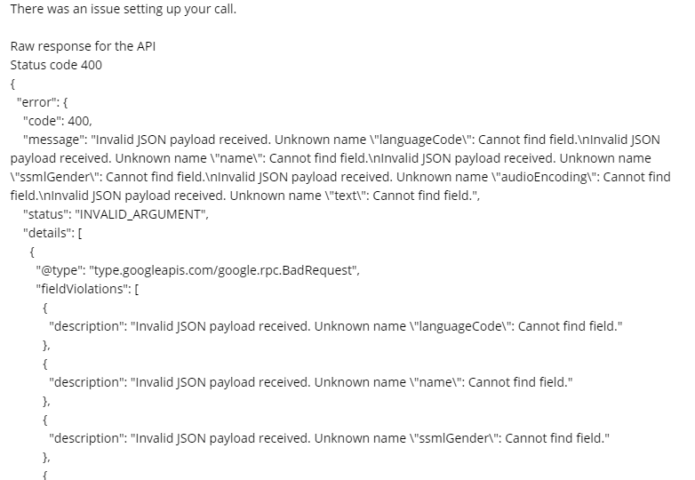

Then appears this error:
There was an issue setting up your call.
Raw response for the API
Status code 403
“error”: {
“code”: 403,
“message”: “The request is missing a valid API key.”,
“status”: “PERMISSION_DENIED”

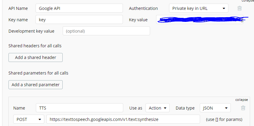

In google, key doesn’t go in the header but in url parameters. Delete the shared header and use private key in url instead
Looks like the key is working in the URL (thx btw) but I’m still not able to Iniciate the call, I don’t know if it’s because it’s needed an OAuth or if it’s because the parameters that are wrong (I’m really lost if this, I don’t understand anything about java or any other coding) I tried to follow the required parameters as the following images:
you will need to add the header
Content-Type with value application/json
And be sure that you match the formatting of the json requested by Google.

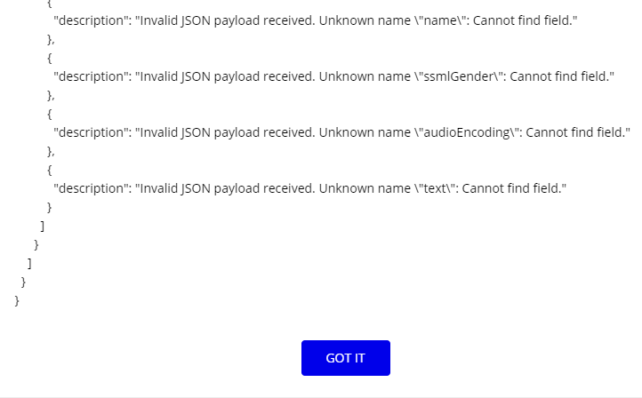

I’m still having problems into making the call.
I entered the .Json as you said, it still not calling, I have no idea why. I’ve tried with my google email and with the e-mail in the json file, both didn’t work.
As for what you said about the audio encoding base64 to MP3, I didn’t understand where to put it (I don’t know anything about programing haha)
here are the prints:
If you could help me, I would be the most grateful!
Double check your JSON. It looks like you have an equals sign instead of a colon after text.
