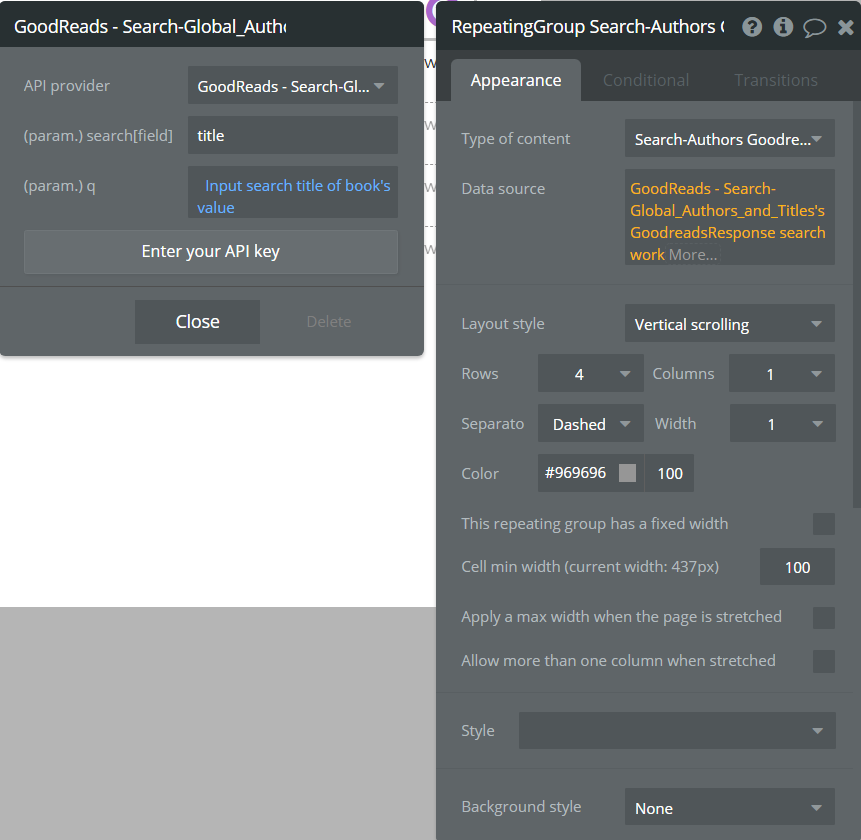

I went through it and put every parameter like i was supposed to but the repeating group doesnt bring any search result.
Can you post pictures of your setup or share a link to your editor? Hard to resolve based on text alone.

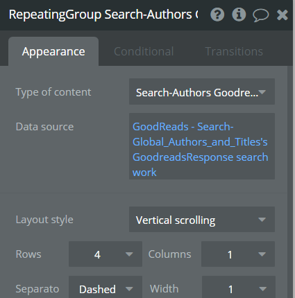

repeating%20group%20settings the%20text%20to%20display%20the%20title
included is the repeating group settings and the text to display the title in the repeating group when a search is made
Could you post a screenshot of the data source? If no results are appearing, it’s likely that you don’t have a defined search term [q] or that the search type [searchfield] isn’t properly defined.
It looks like you have not added an API key. Register as a developer at GoodReads.com/api and add your API key to the plugin. Otherwise, your setup looks correct.
