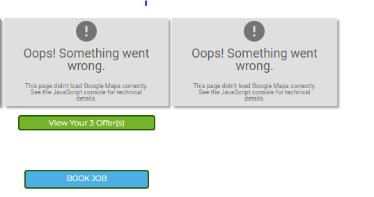

I recently noticed an search box designed to take in Geographic places data (which I’ve used for years), stopped working on an app (on a Personal Plan) I’m working on.

The search box still isn’t working and other places where I’m using Maps seem to give me a Javascript error

Typically the Javascript error shows up when you haven’t selected the Javascript APIs. When you created your API key(s), did you select all of the APIs Google offers or just a selection of them?

Yeah, I finally figured it out and I had the Places API disabled for some reason. It’s fixed now
