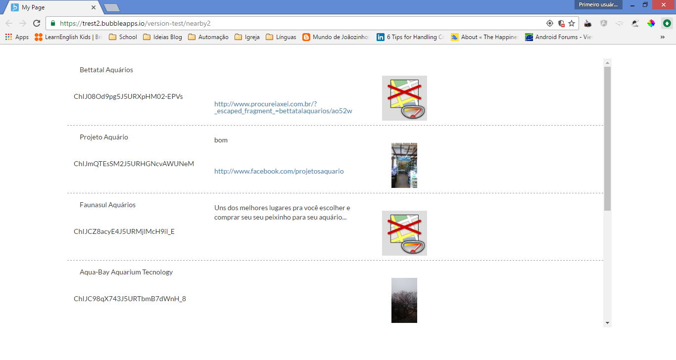

For your app example I get a mix:
EDIT: if I copy and paste the entire code with key, the browser shows the picture. It only shows the Forbidden icon if I remove the key parameter. But on the repeating group the key parameter is present.
