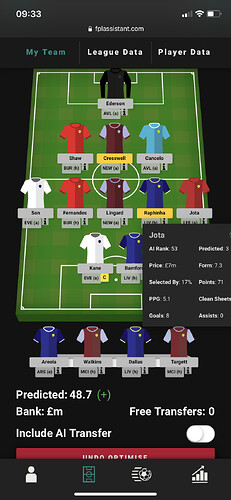

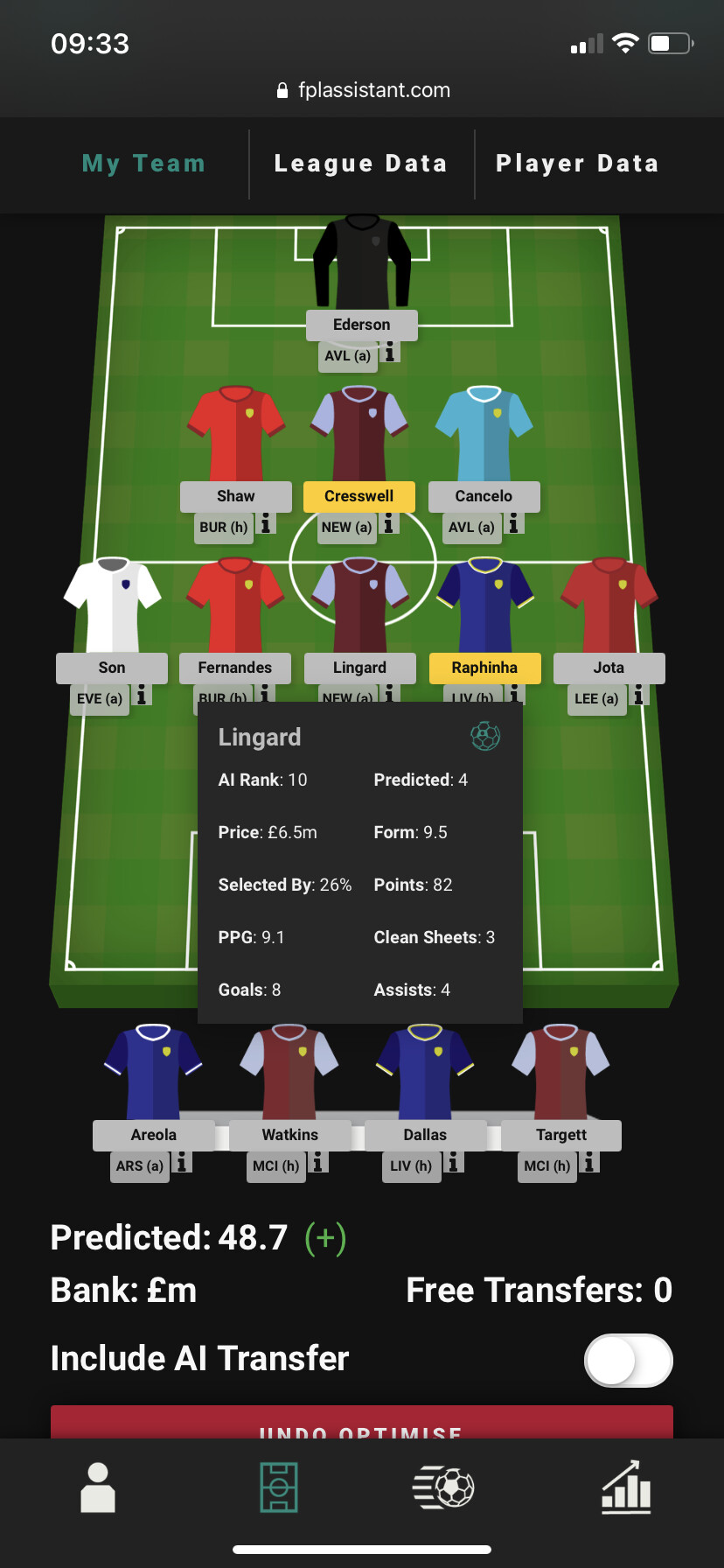

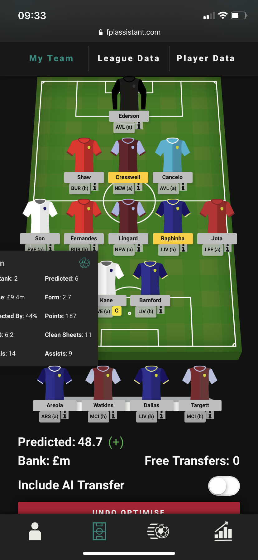

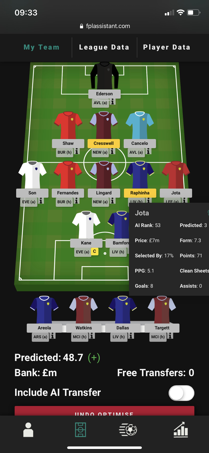

On mobile my group focus within my repeating groups will go off screen for certain elements. Is there anyway to keep a group focus always on screen?
Offsetting it based on screen width doesn’t really work here I don’t think as the RG goes from left to right and so one side need a certain offset different to the other.
