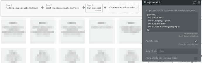

Ah, thanks @NigelG! I read that post several times, but kept skipping to the “solution” so I was missing all the stuff that mattered! For anybody that comes across this post, here’s exactly what my config looks like (and it appears to be working as expected across the board):
PLUGINS I’M USING FOR ANALYTICS
1. GA CONFIG
2. TOOLBOX CONFIG
No config necessary in plugin itself
3. ADDING EVENT TRACKING TO BUTTON, ELEMENT, ETC
More GA Documentation here on what to drop in: Medición de eventos  |  Analytics for Web (analytics.js)  |  Google for Developers
