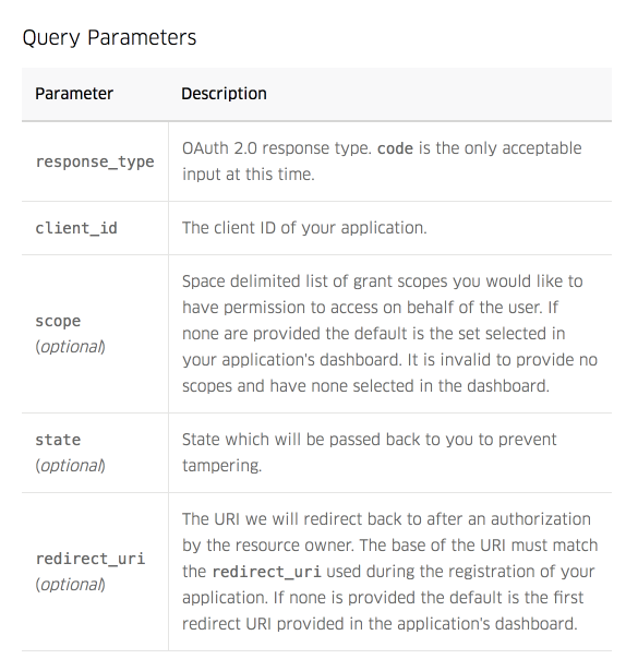

Were you able to make it work with multiple scopes?
Yes.
You need to define the different scopes in the in the initial OAuth request
That’s the crazy part. I read in the documentation that the scopes were space delineated. Is that how you set it up? I can get the token with just one scope defined. Not multiple.

Did you include the scope in each call? I haven’t done that.
That would be correct. Scopes are usually separated by space, not just for uber but also most apps
I’m getting this error. is this a bubble thing?
solution:
Put the scopes in a specific order where the PROFILE scope is last.
