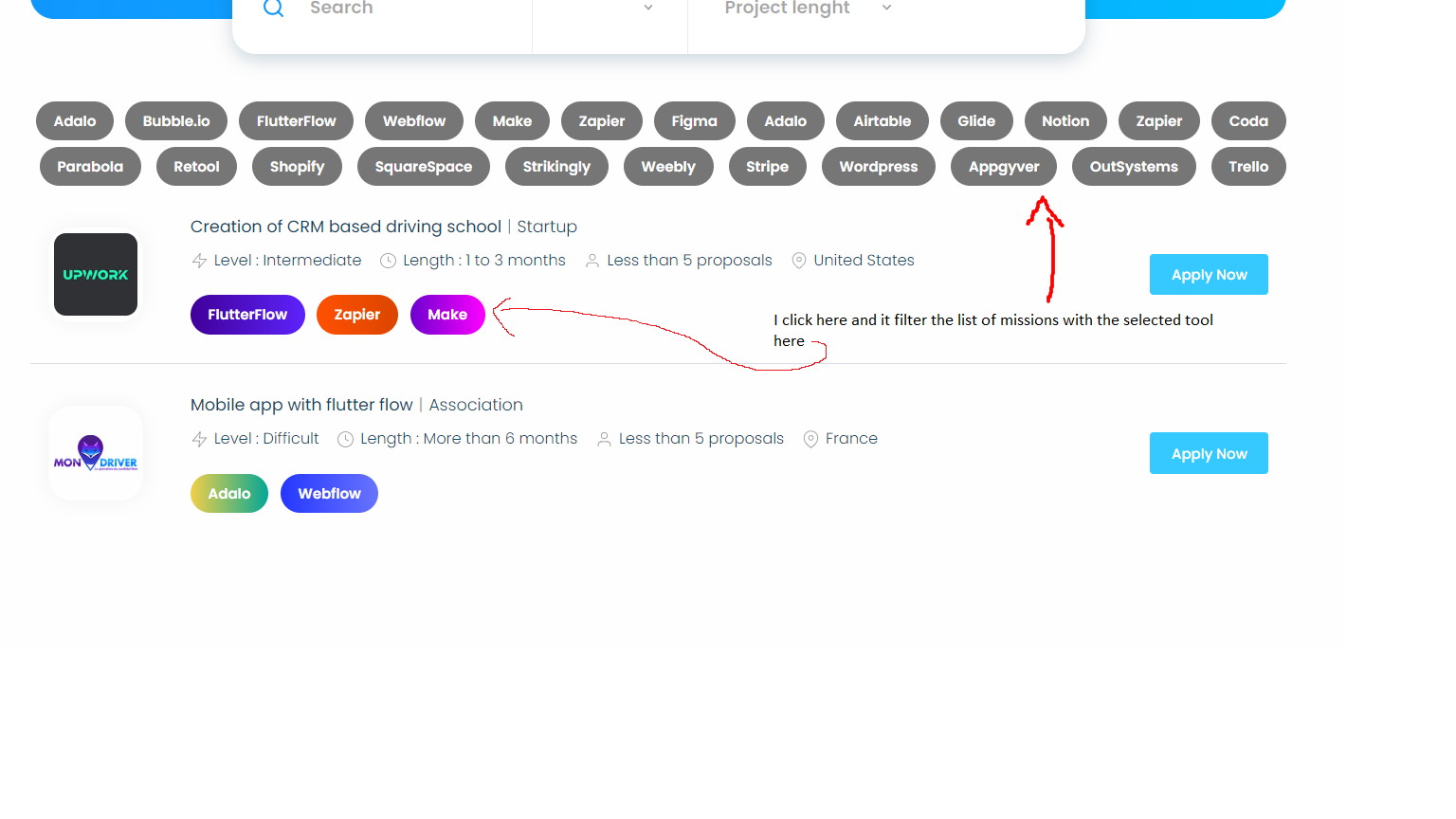

Hi! I’d like to create a system where I can filter a repeating group by clicking on one of the tools (repeating group of an option set) and it filters the list of missions below
Hi there, @rayanerachid91212… one way you can do what you described is to add the tools to a custom state list as the tools are selected in the filter. Then, assuming you have a field on the Mission
data type that stores a list of tools from the option set, this advanced filter on the mission repeating group’s data source should produce the desired result.
