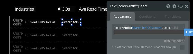

Here’s a example where I have a repeating group for industry and do a search for ICO to bring back matching data for Industry:
I think the fundamental issue is that it looks like you building your own “foreign keys” to link all the tables together.
Bubble is a lot lot easier if you use the built in relationships using custom data types and lists.
Linking two tables by searching on “unique ids” is rarely, if ever, a good solution in Bubble.
