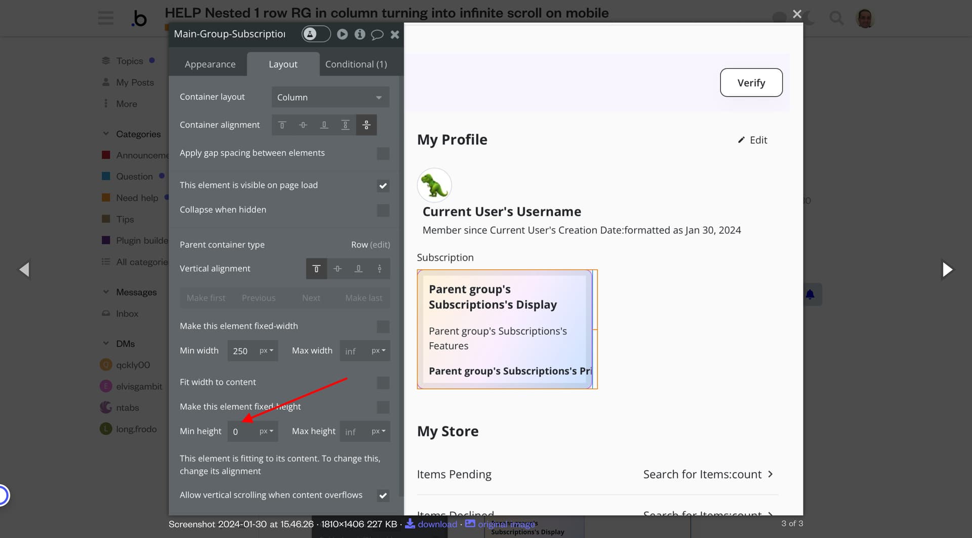

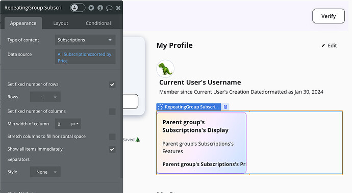

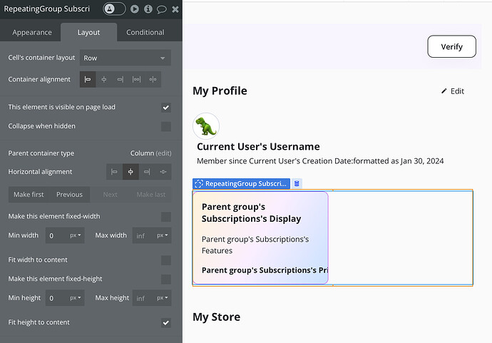

Here’s my setup for the repeating group:

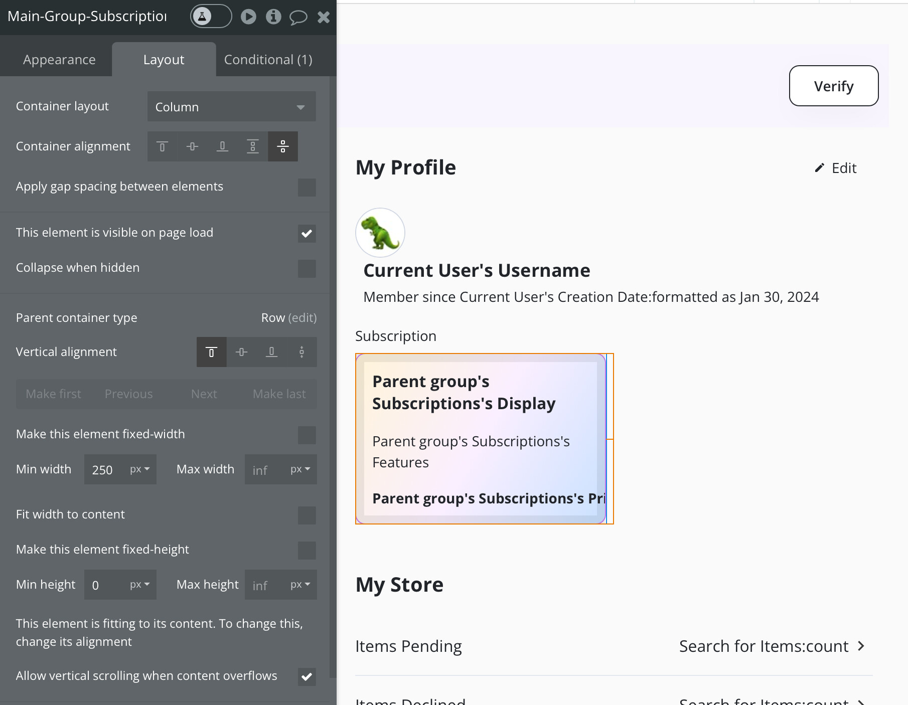

And here for the group inside of the repeating group:

Sorry I don’t understand what you mean with the arrow?
Minimum height is absent. You may need to set it.
@mulleralice984 it is highly likely that the minimum height set to 0 is not affecting your setup negatively at all. The minimum height is a minimum height, implying the height of the element can not be any less than the value set, so it is not determining whether or not something expands its height. The expansion of height is determined through Max Height.
On the Main Group subscriptions you have the ‘allow vertical scrolling when content overflows’ checked…it should not be. Also the Max Height should be set unless your repeating group cells height are variable based on the content displayed in the Main Group subscriptions (which as I understand is inside of the RG).
Overall what you want for the RG setup seems to be correct with a set number of rows at 1. The main issue is the Group that is Containing the RG, which needs to have a fixed height set to the height of the ‘card’ displayed in the RG (card being the Group Main Subscription that displays all the details).
Remember, you are not attempting to have vertical scrolling, you are attempting to have horizontal scrolling.
