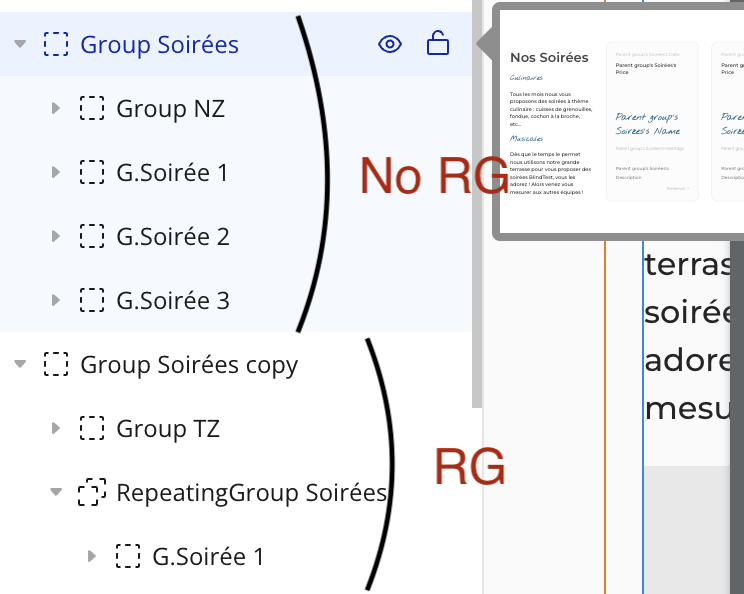

I have 2 main group on my app (both the same) but one is a RPG (that works perfectly well with data) and the other is a non RPG (that works perfectly well with responsiveness) but why I can’t success to make the RPG responsive as the non RPG ??? :exploding_head: :exploding_head:

And if needed this is the hierarchy :
