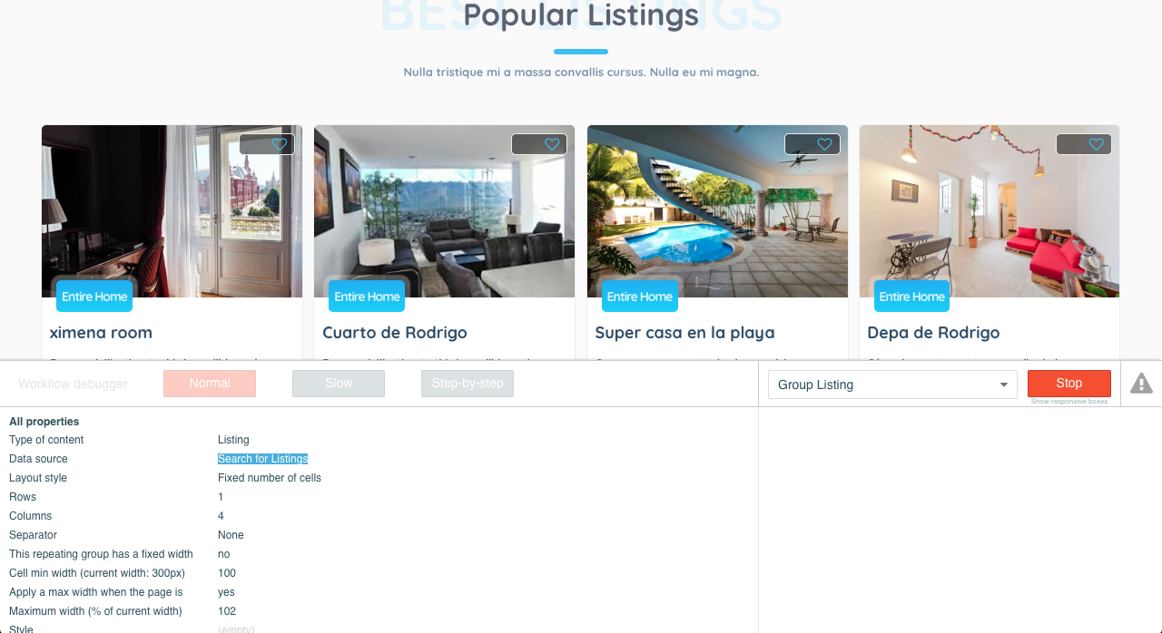

This is what’s showing. I just tried to enter another repeating group box, and anything I add in it like text and such also just doesn’t show. I think it’s a problem on Bubble’s side…
I mean inspect the element, not the workflow. like this:
click on “Inspect” in the bottom right corner button.
select the repeating group in inspect mode:
click on the data source in the inspector to see what orders are being displayed in the repeating group:
If it’s blank, probably there is no order who match the requirements to appear in that repeating group.

Done, the issue was that non of the orders were meeting the requirements to show in the repeating group, this is because in the repeating group you have as condition that the boolean value “placed” of the order must be yes, but all your current orders have that boolean value empty. I changed the value of one of those orders to “placed=yes” and it appears in the repeating group correctly. So you need to change somewhere in your workflow where to change the “placed” to “yes” or set the default value of placed as yes in the data types tab of your bubble app.
