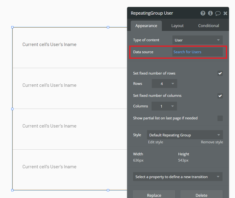

Your setup is incorrect. Click on the repeating group itself and set the data source here.
Then, notice what is being displayed in the text element within the repeating group (i.e., the current cell’s user’s whatever).

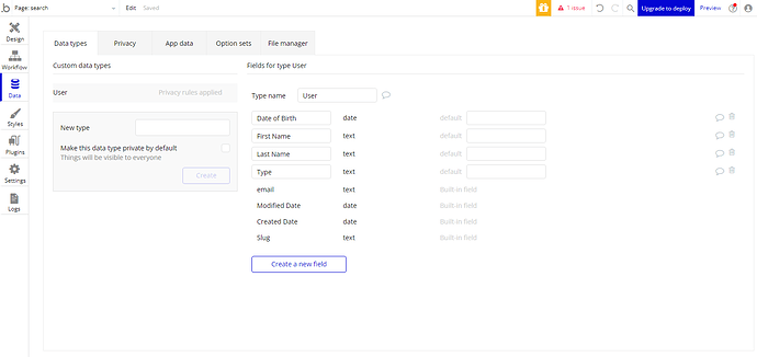

Finally, even when you set it up correctly, you aren’t going to see all of the users you are expecting to see because of this privacy rule, and you will need to address that issue.
