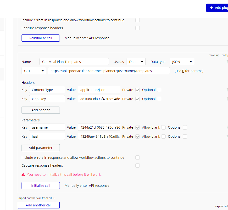

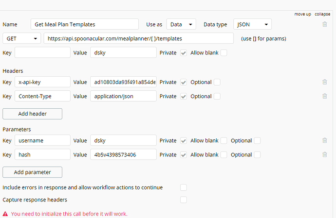

Hello, so I am trying to create a meal plan web app where users can generate their meal plan. Using spoonacular’s API. I was able to set up some of the calls I need on Bubble, such as connecting users with spoonacular
However, I have been unsuccessful in trying to set up additional calls because they require a variable path for the user at the endpoint. I keep getting ‘‘you’re not authorised’’ error response when I initialize the call. I’ll be glad if I can get a way around this block

Yes, I don’t know how to correctly insert the username variable.
I tried that,
but I still don’t get the whole setup

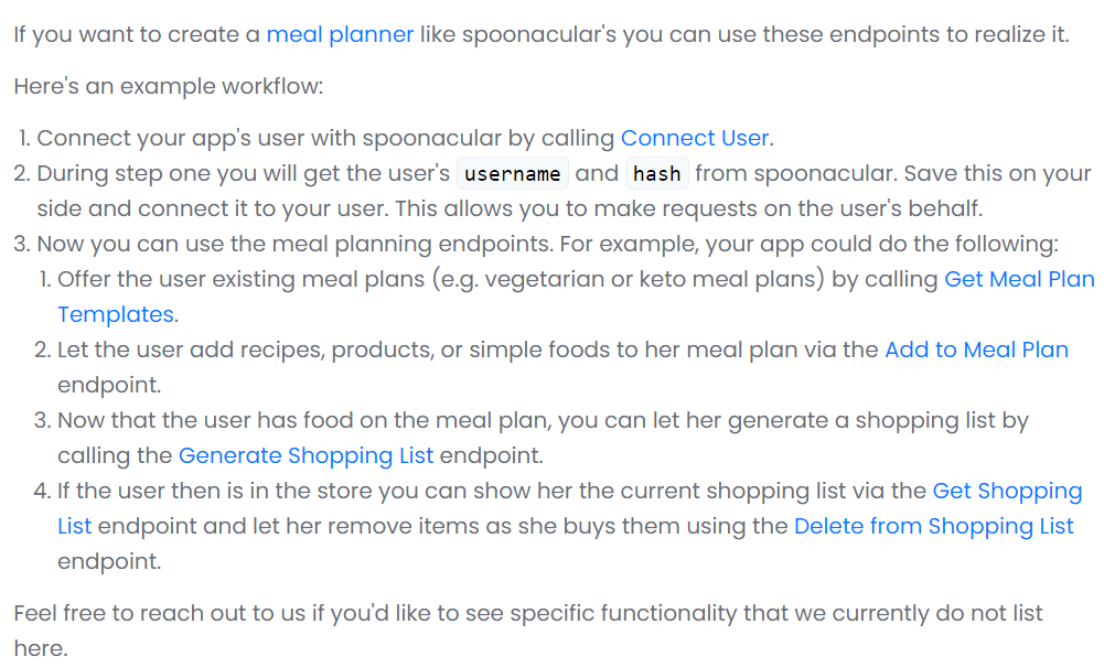

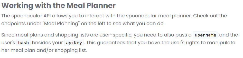

Well, of course! You are trying to use the username and hash from the example. But you do not have rights for this user.
Read this carefully:
Connect user:
After connecting, you will receive the necessary data for further work:
“status”: “success”,
“username”: “user-1”,
“spoonacularPassword”: “colawithxxxx”,
“hash”: “d8e37a0a0a0558417edc1a9aa80368bXXXXXXXX”
Add a Meal-Plan-Template for it:
And continue down the list from the “Working with the Meal Planner” guide.
Oh, I thought it would still run using the example. I created some usernames with the hash as well.

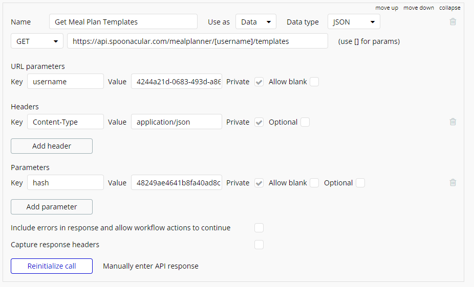

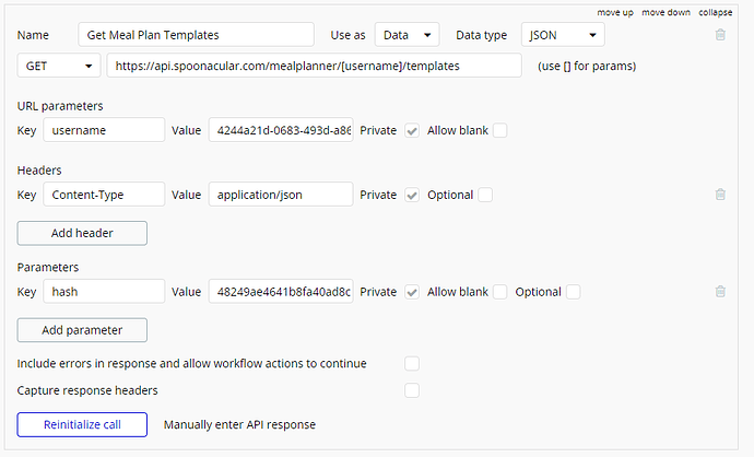

I know I’ll need the username and hash to get meal plan templates but I can’t figure it out. Here’s my attempt
You can only use “x-api-key” and “Content-Type” in the header once, not in every call.
no need to put “username” in parameters. Use “username” only once in the url (use square brackets instead of curly braces).
Wow! I retried it with the corrections you made and it worked. Thanks so much

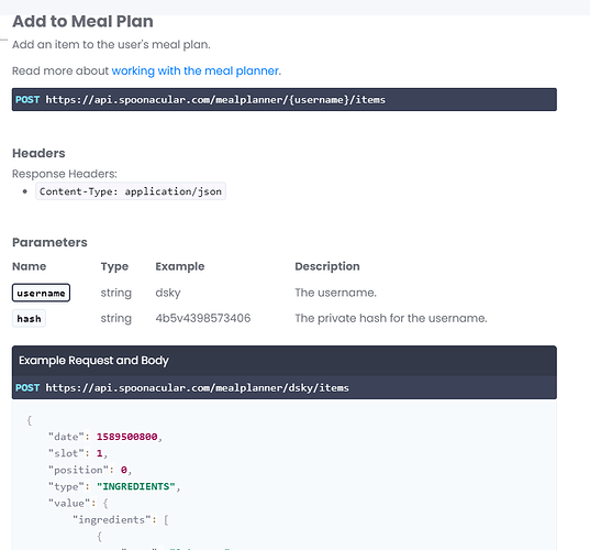

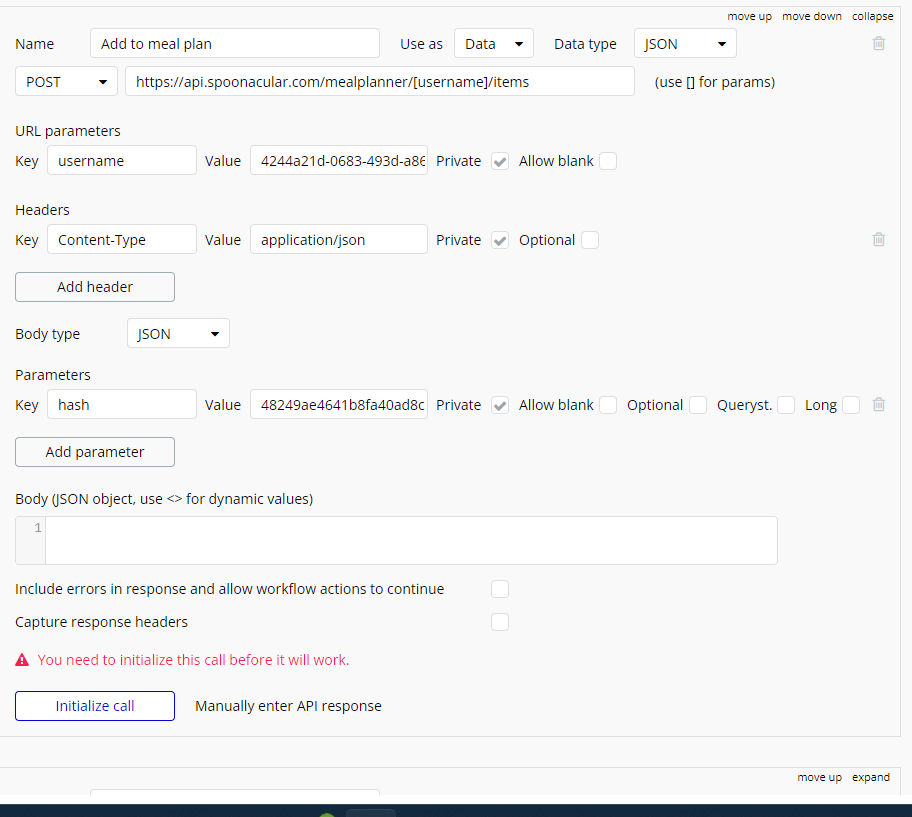

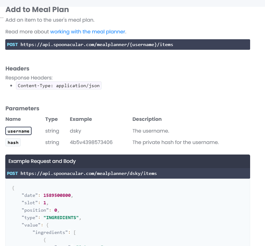

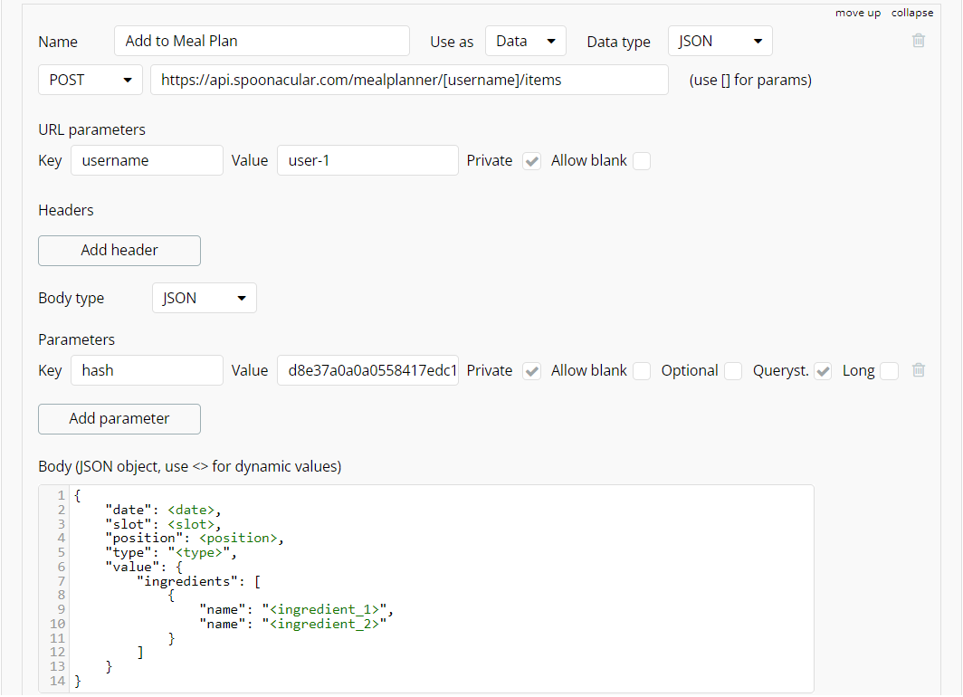

Will you be so kind as help me with this Post method as well? Thanks
Amazing! Thank you
