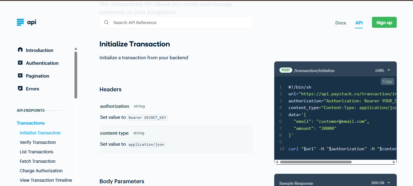

(“status”:false,“message”:“Format is Authorization Bearer {secret key}”,“nextStep”:“Ensure that the authorization header follows the format: "Bearer YOUR_SECRET_KEY" Ex. "Authorization: Bearer sk_123456789"”)

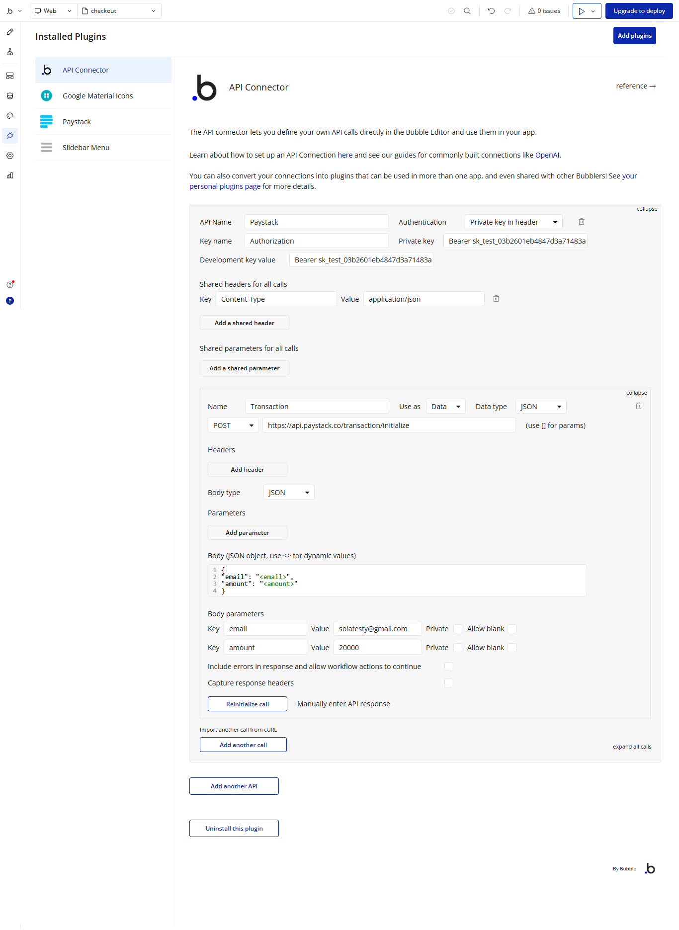

  1. Set up the API Connector for the POST call to https://api.paystack.co/transaction/initialize.
  2. I’ve added the email and amount as JSON body parameters.
  3. I’ve added a header for Authorization. I’m using my Test Secret Key from my Paystack dashboard.

    Could someone please take a look and see what I’m missing in my Authorization header setup? The error message mentions “Bearer,” and I have a feeling I’ve implemented that part incorrectly.

Please share settings in API connector.
This right?
Delete authorization in shared headers. You already set the authorization in the previous fields.

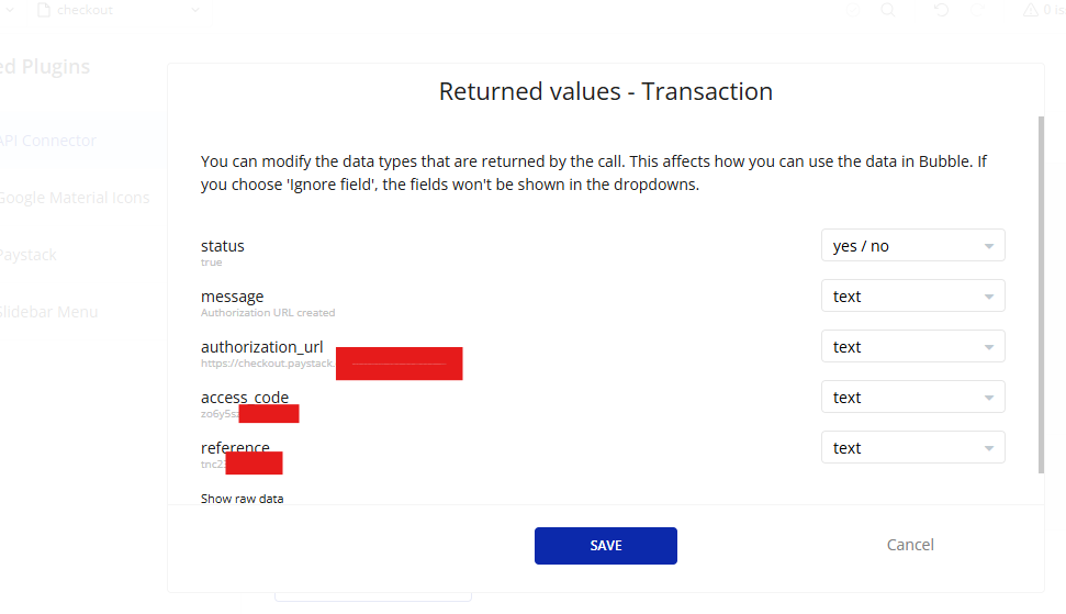

I think you are not using the correct call because in your screenshot, it just say “Transaction” in API connector but “Initialize Transaction” in run mode …
From what I can see also, your call is set to “Data” in API connector but this is the kind of call that should be set as “Action” instead
i actually thought one can name a call with “any“ name, so i just typed in Transation; but even if i change it to “Initialize Transaction“, the call still initializes
I chose “Data“ in API Connector folowing the Paystack documentation that I saw. I am still very confused.
You can give any name… but actually you are not using the correct call in your workflow! What I’m saying is that you have another call called Initialize transaction that is the one set in your workflow. The “Transaction” call is a different call. Check in API connector if you find another API Called “Initialize transaction” (or maybe you tried a plugin and this call is from a plugin?)
Data can be used with Get Data From API (mostly in RG or group) while Action can be used in workflows. Actually, you are triggering the API call using a button, so you should set this as action. Once it’s done, you will have access to this call in the list of actions in worflow. Nothing in paystack doc will tell you how to use it in Bubble. This is just telling you how to configure an API call
