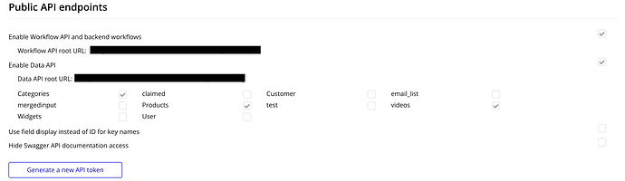

Hi community - I have been looking for answers to this topic, but haven’t found any guidance. I want to open up a few tables to third-party developers, and I want only certain fields to be discoverable through the Data API. The solution might be privacy rules, but how would I set this up if I need the fields for the application to run?

Thank you for your response, I just sent you a LinkedIn invite. It’s still unclear how I only hide certain fields from the API to ensure none of the privacy rules impact the rest of my application.
You can’t. In normal web dev you could provide an api key with a certain scope but such a thing isnt possible natively in bubble.
You could construct a custom endpoint that only returns the data you want. But if the third party has that api key they can access it regardless because you cant delineate such restrictions in bubble
