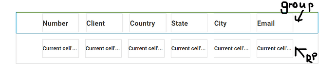

Hello I would like to have a repeating group that I can scroll horizontally as I will be putting a lot of texts, including the group above the repeating group for the headers like the video above. May I know how to do it?
My current one is the picture that is shown. So there will be more fields hence may I know how should I do the horizontal scrolling and putting in more text field in the repeating group?

My repeating group is using fixed number of cell. What I will like to do is to put more text field to the right in my repeating group. However, there is not enough space for me to put more text field to the right in the repeating group. I cannot increase the width of the repeating group as it will look very ugly in my website. So I would like to have a horizontal scroll to the right to show more text fields within the fixed width repeating group.
Have you considered placing a horizontal scrolling repeating croup within the first cell of this repeating group?
Hi @dazhane . I tried it just now it does not work.
