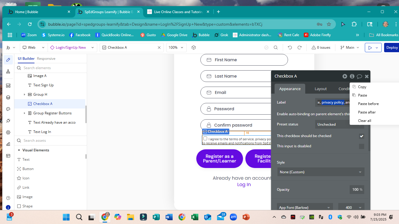

How can I insert a link to my terms and privacy policy in the checkbox input?
The rich text editor does not appear below the label box of the check box input. I tried copying and pasting it from another place, but it didn’t work. I tried highlighting it and right clicking. I tried dropping a link into the label input box, but no. Surely there’s a way, right?
No, you can’t do it the way you’re trying.
The checkbox element does not accept rich text markup.
If you look at the template you’re using, they just used plain text.
If you want to add links to the text, you need to group the checkbox in a row group and then add a text element beside it. You can then add your links.
