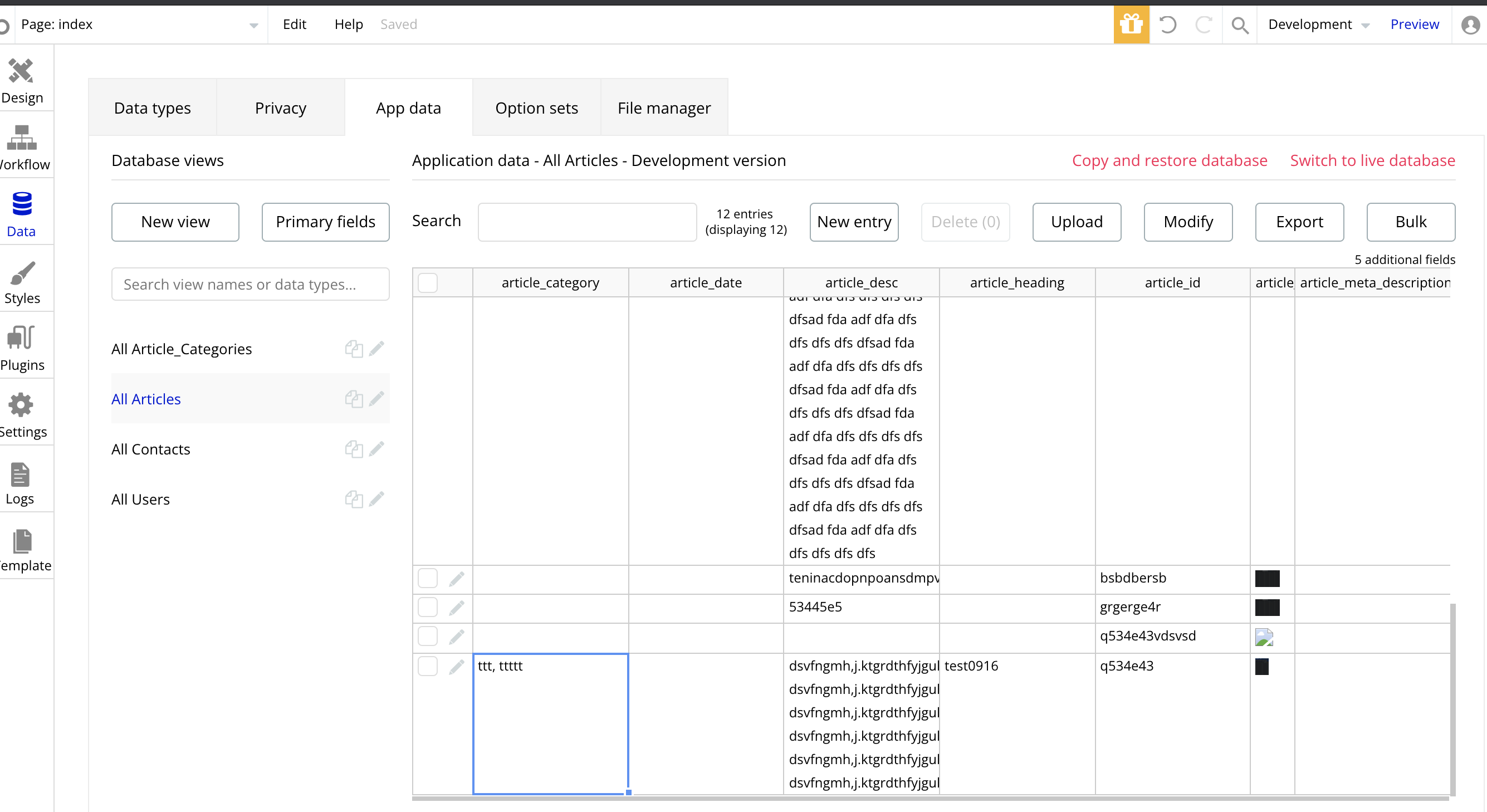

Items that are already selected will not be displayed. For example, on this screen, “ttt” and “ttttt” are already selected categories.

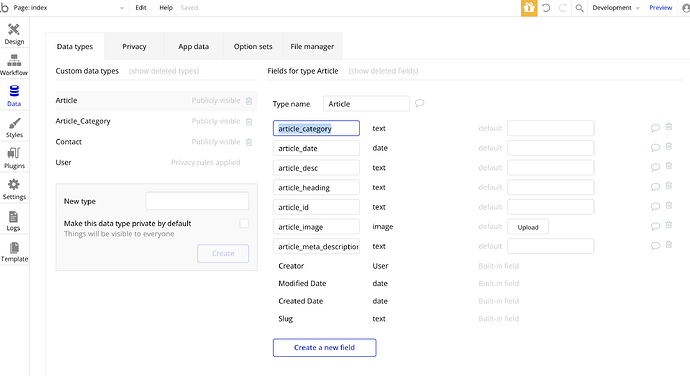

Looks like you are storing the checked value on the Category itself?
you need to store a list of checked categories on your blog data type instead.
You could also consider using option sets if your categories wont be edited by the users much.

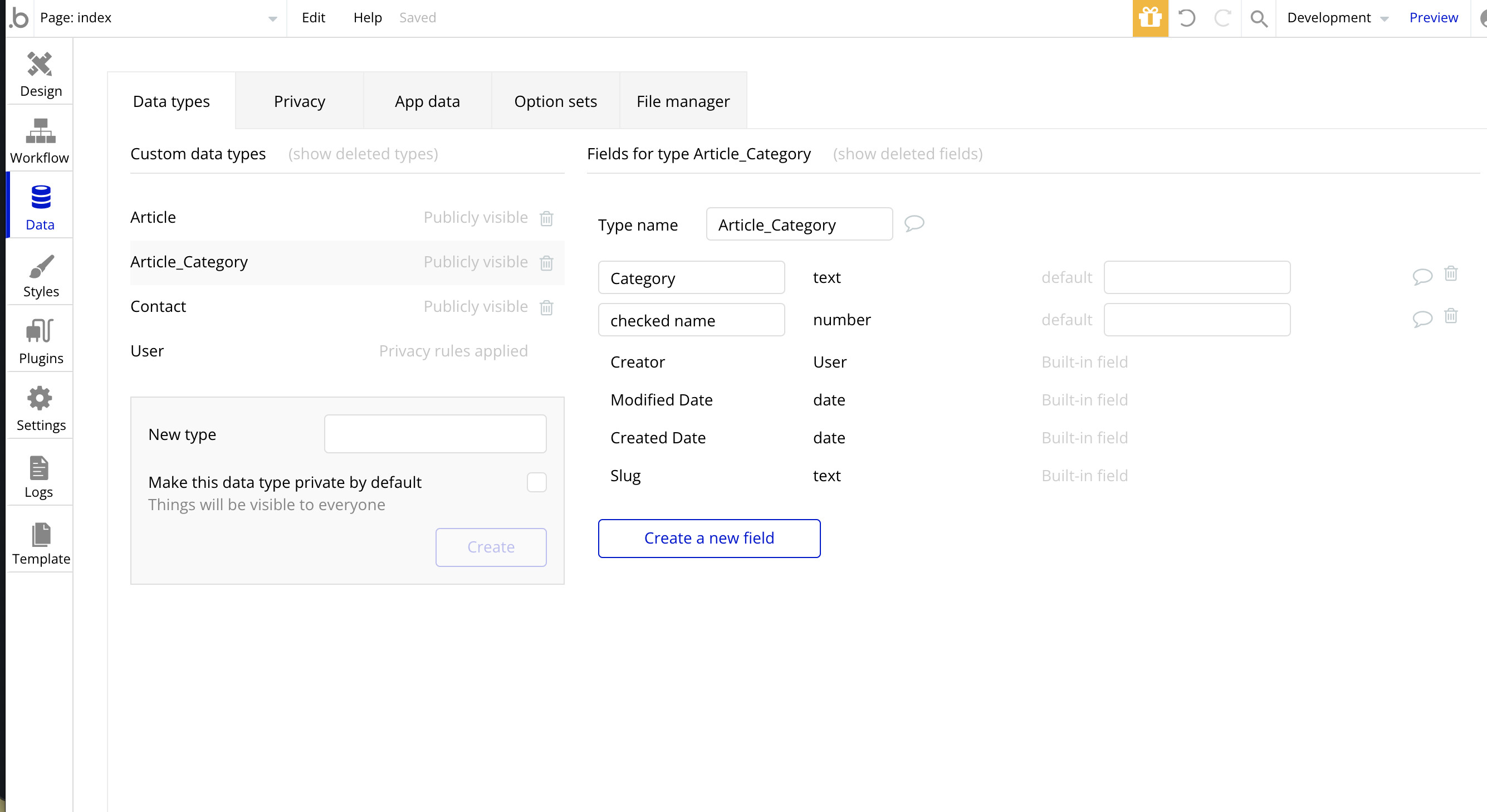

Categories and categories set for articles are managed separately.
“Article_Category” is the master, and the selected category is saved in " article_category" of each article.

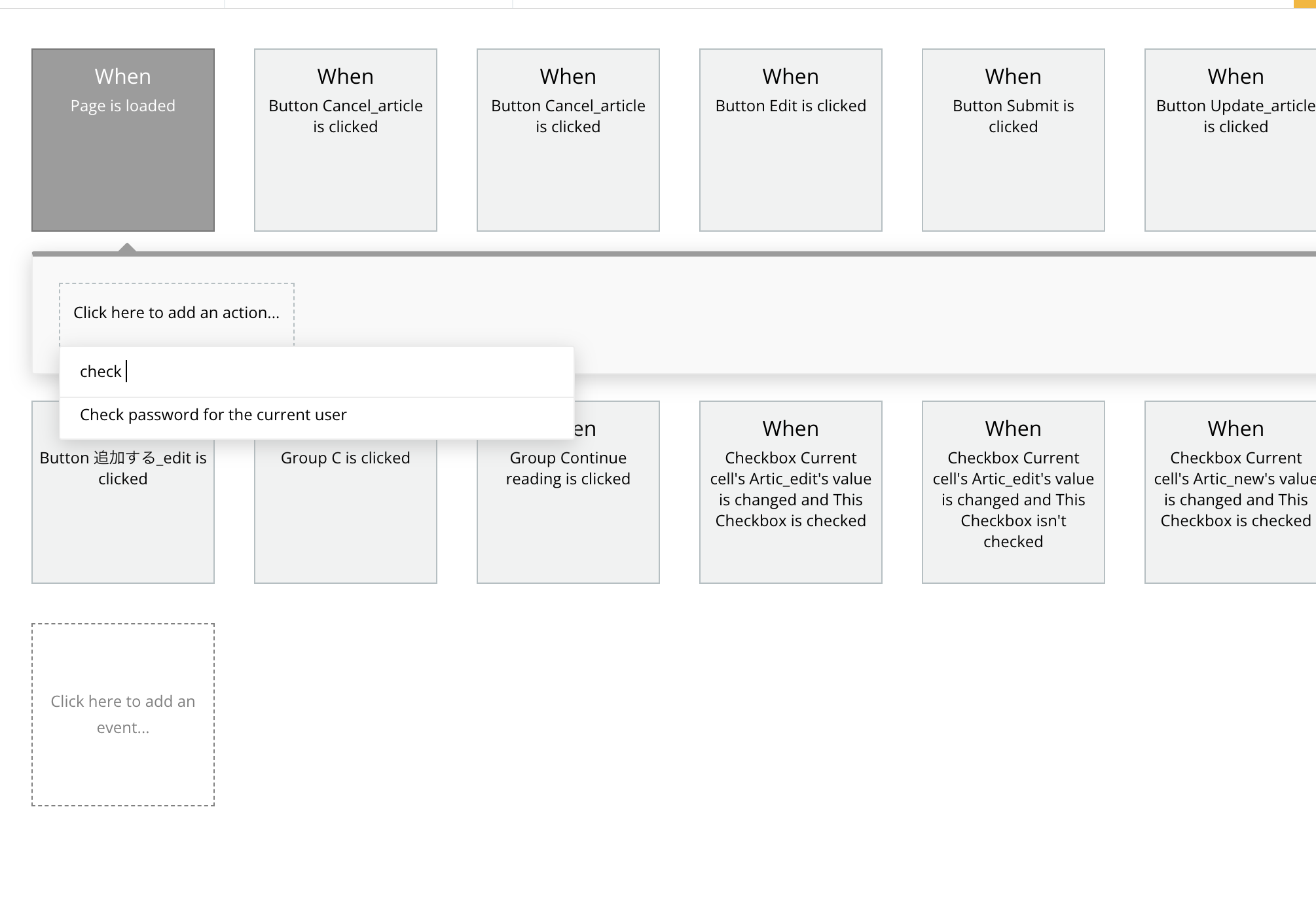

You could check on page load. If this checkbox has been checked previously (and somehow saved at the database) you can make a Do a Search for while page load and set the states correctly (as if someone would click on it).

I thought about that method, but I don’t know how to set up the workflow, so please let me know.
What I did was try to go see the state of the checkbox when loading the page, but there is no checkbox in the menu.
I also thought about doing the checkbox action when the page loads, but it doesn’t seem to work.
You need to think differently here. You don’t want to check whether the checkbox is been checked. You need to check whether the value which represents the checkbox is stored in the database.
In your case it’s “ttt” and “tttt” in the article_category. You will need to check for your particular case whether this is already in your database (so to say it’s checked) and then either set the right states for that or present it directly in the checkbox (conditions, if something is true - present status (check).

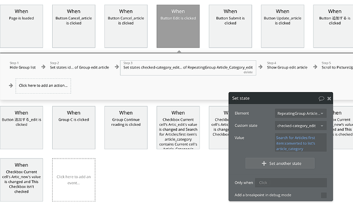

As a result of designing based on the advice, the purpose was achieved.
I did this by passing the Listed categories of IDs of the selected articles to Custom State in Set State.
