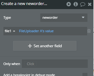

My clients ask us to mockup a tshirt. We have a dropdown list of different locations their artwork goes on the tshirt (Front, Back, Sleeve, etc…). They can then upload their artwork for us to mock it up. However their file names are always quite crazy, and I want to just change the name to the location. For example the file name would be Front.ai or Front.pdf so it doesn’t change file extension or the file itself, just the name.
Is there a way to do this when creating the new thing?
