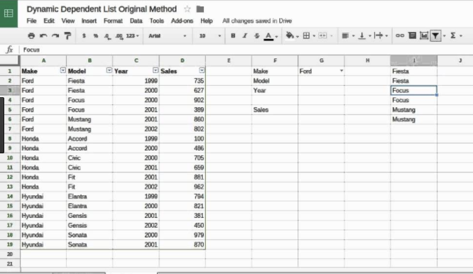

The app I want to build, is basically a clone of a Google sheet that I built. This sheet performs some complex date calculations and I find it unlikely, that bubbles can perform these.
Thus I assume, that I will have to build an app that basically appends a row of data to this sheet, which then performs additional calculations with the data in the row and among all rows. Then I will have to display the result of these calculations in bubbles.
I figured I could use the bubbles API to post and get data from Google Sheets.
My question: is this the best way to go or do you have any other/better ideas?

If you’re able to run the calculations directly in Bubble, then that’s going to be easiest. There are some plugins that extend Bubble’s calculation abilities a bit if that helps.
If that’s not practical, then you can definitely connect to an API to run the calculation in Google Sheets or elsewhere. We’ve mostly set-up our algorithms in custom code and hosted them on Amazon Lambda. This works well. I suspect using Google Sheets is pretty much the same although I haven’t used it’s API in a long time. Plus, based on your scenario, it sounds like it’d be a straightforward implementation.
This will trigger a webhook to your app’s API after Sheets has completed your calculations. Make sure to enable your app’s API in the settings tab of the editor.
