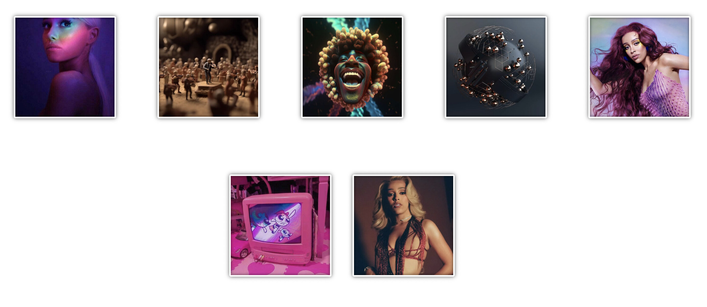

How do I centre the remaining cells in a repeating group?
How do I get the remaining cells in a repeating group to centre? Currently, they align to the left but I would like the cells centred to look nicer. This is what it looks like currently:
Please can someone help me getting it to centre in a way that if I add more products (marked by the red rectangles) that it would automatically adjust. Thanks!
Are you using align to parent, row or column for the groups in the cells?
Column but I have now changed it to align to parent to see if it makes a difference.
I’m still stuck with this problem.
Hey, hope my explanation is helpful.
So here’s how you do it:
This is the repeating Group:
I’m assuming you already know to wrap it horizontally AND stretch columns to fill horizontal space.
This is the group that is inside the repeating group:
It is vey important to have it be aligned to the right.
Now, you add a conditional to the group that will say, when this group is the last group of the repeating group, align it to the left instead. The last item would, of course, be the count of items in the repeating group.
This is without the conditional statement:
And this is WITH the conditional statement:
Alternatively, you could have the group be aligned to the left by default, and in the conditional, do when: current cell is not repeating group’s last item → align to the right. You choose whatever you want!
Again, hope this helps. Let me know if you have any question!
Cheers buddy! :slight_smile:
Thanks. This also helped me with a little alignment issue that I had ignored until I can look into! :slight_smile:
