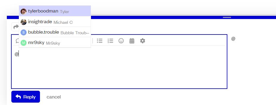

i tried the same without being aware of the input watcher thing. But i am stuck at the workflow for adding the repeating group selected value to be added to the input box. Like when someone enters @ in the input box, i have trigerred a workflow og When a condition is true - everytime - the input contains @. The group focus shows up with the repeating group. But no idea what to do after that where i want to add the user selected from the repeating group to be added after the @ just like twitter or facebook.

But where i get stuck is adding the text inside the input box after the @ symbol just like this bubble forum input box and not extracting tags from an entire text. So basically inserting the selected user’s username inside the multiline input box after the @ sign and continuing to input text thereafter.

@tylerboodman I want to build the exact same tagging system as in this bubble forum reply input box.

Let me think about this one, keep in mind the Bubble forum doesn’t run on Bubble. Definitely some regex and custom CSS involved to find the location of the cursor to put the list of users.
