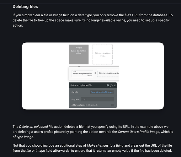

Thanks for replying. I’ve gone through this link. I gives info about privacy, deletions etc but there’s no info about how to copy the private files or unprivate them.
