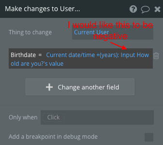

I have a similar issue:
I get a positive integer from an input field and now I want to subtract this integer from the current date with +year. (People type in their age and I want to calculate and save their approximate birthday).
Do you have any suggestions for me how to do this?
Thank you!
Nicola

Hi Keith,
I already tried to do that, but it does not work. It seems that I cannot get the syntax right. Could you please show me exactly what I need to write.
Thank you!
Nicola

Well, the expression entry field strikes again. (We kinda sorta do need “-(days)” to do this in one fell swoop.) Once your expression resolves to a date object, the expression is done.
So you have to do the negation first somewhere else.
In @nicola.kegel case, they have an input. That input will have a positive value in it (they ask the user “how old are you?” presumably meaning enter the number of years in age that you think you are).
So, they shouldn’t be using the value from that input. They should put a custom state on that input. Call it “negative years” or whatever (type number). Then they should have a “when that input is changed” workflow that simply does element > set state negative years to input years value * -1
And so their Make changes should look like:
Birthdate = Current date/time +(years): input How old are you’s negative years
You would need to do something similar.
(This is a general issue with not having parens and such in the expression builder, @emmanuel… The example above is sort of dumb, but this problem arises in more real situations where you really really really wish you just had -(interval). I have some complex date workflows where this crops up all the time and its truly a pain to go and figure out where we can do that negation precompute. Additionally, if this were an API workflow you would be well and truly effed as there is no place to do such a precompuation (though there will be if SSA performance can be improved – on of the lil SSA plug-ins I’ve built is called a “flow state” and its exactly what you’d imagine – an action that just holds a value (as a custom state does) for referencing in downstream workflow actions.)
