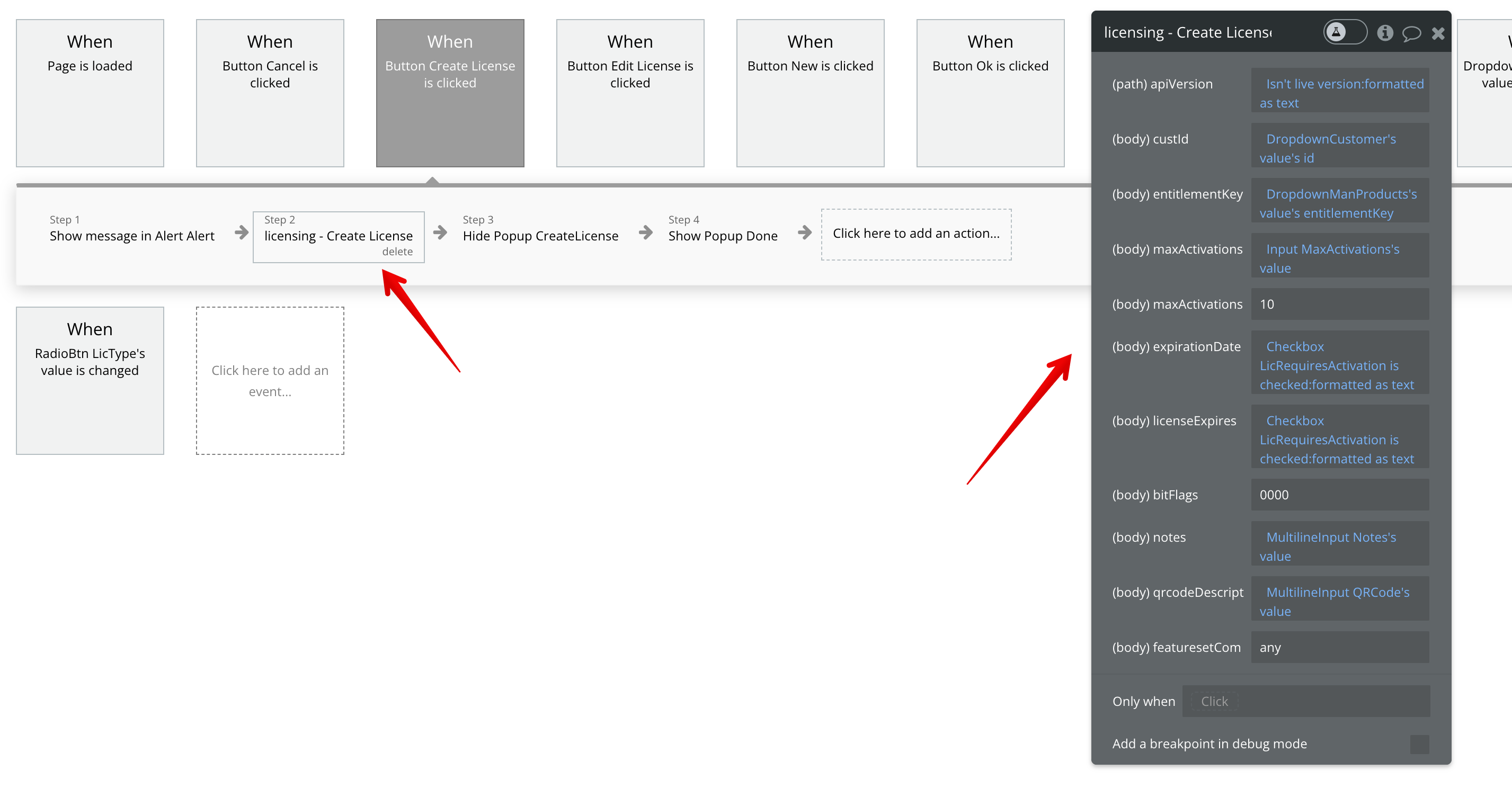

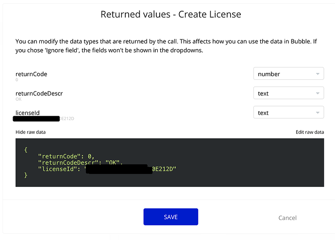

I am using the API Connector to create a record and my REST API Is returning the status and the record licenseId. I execute the POST in a workflow action. I have verified that the API call does return (See below). How do I access that returned data? I would like to navigate to the another page where the user can further edit the data.
Here is the workflow

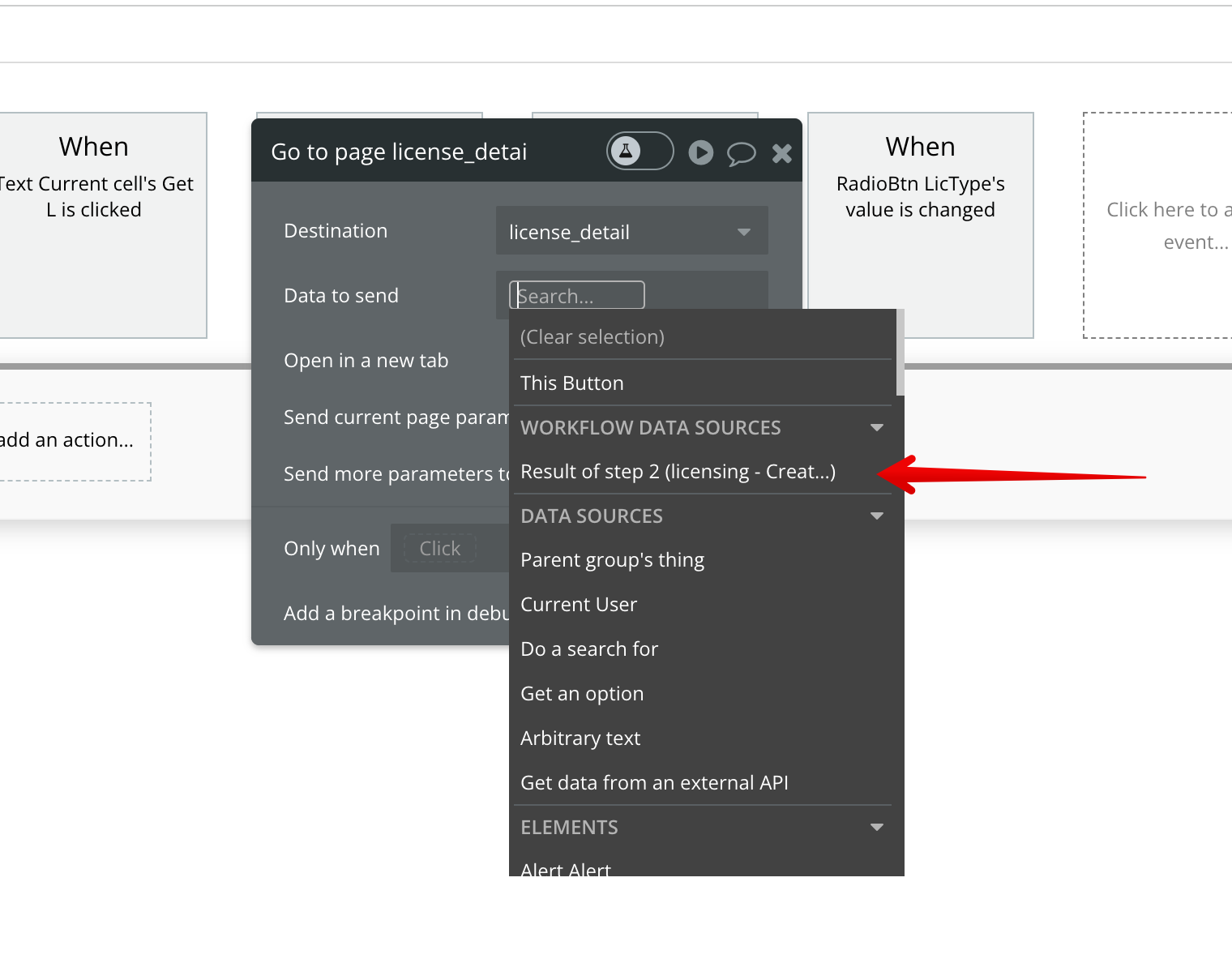

You will be able to use data in future action using result of step (2 in your case). You should have access to all three keys saved in API connector (returnCode, returnCodeDescr and licenseId)
Thank you, I just figured it out. I did Navigate, and then selected “Result of Step 2”
