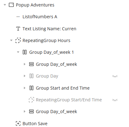

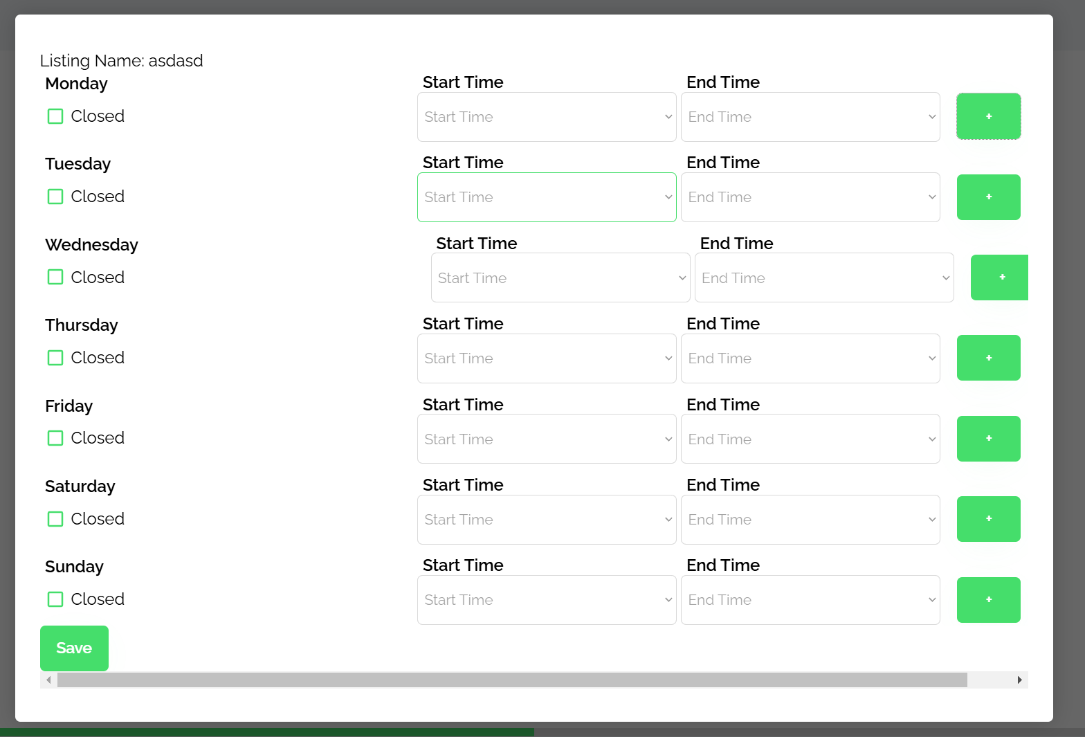

This Popup that contains and displays Monday to Sunday is a repeating group and inside it is also a repeating group for Start time and End Time which I was tasked to when I press + then it should add a new start time and end time for that particular day I’ve got that figured out already but the problem is on how do I save it

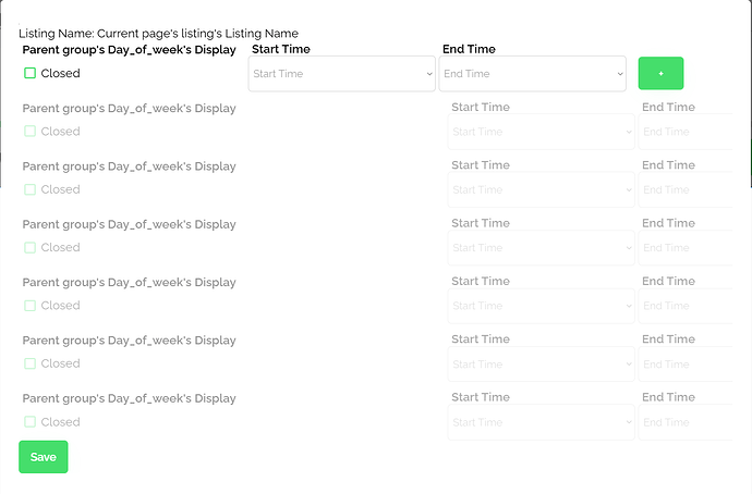

Here’s some screenshot of it

On your solution I have separate file for the purpose to not just mess up the main file and it’s kind of close to what you showed me though the UI is different
