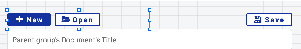

Desktop:
  • 2 groups (left & right) of equal width
  • 2 buttons on left, 1 on right
  • the buttons are fixed width (100px), the groups are not
Mobile:
  • all 3 buttons should be on the same line but i can’t get them to
Desktop:
Mobile:
Hi @jayy,
Here’s a trick I’ve figured out for this - it helps to have a variable-width group between them. Here’s how I’ve been able to make this work in the past from trial and error:
  • Group A = the parent group
    – Contains Group B, Group C, Button 3
  • Group B = The teal group
    – Contains buttons 1 & 2, all buttons are fixed width.
    – Is fixed
    – Has extra space in it in case the buttons get too close, but since your buttons are only 100 pixels each they shouldn’t crash on mobile.
  • Group C = the red group
    –Doesn’t contain anything, is just there to span between the buttons.
    – Is variable
    – Has a minimum width of 0%.
Here’s how all of those fixed/variable settings look together:
Result:
When you size it down it will shrink until the red disappears. It will push button 3 to the next row if that happens, but seems unlikely in this case unless the mobile screen is very small.
Hope this helps, and best of luck with your app!
Adam
