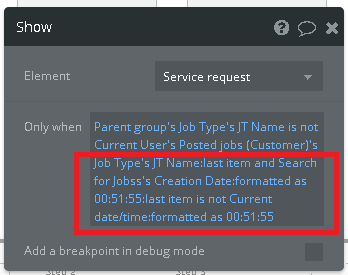

Hi,
I am trying to create a workflow wherein once a request is placed the same request does not get placed for the next one hour, and after one hour the previous workflow gets canceled, so that request for same service can be placed again. (This is to avoid duplication of requests)
This expression seems to work but I can not define a timeline here.
The option of (+hours) is not available in ‘Do a search for’ , it is available with Current date/time but then a (-hours) option is not available with it.
Can someone suggest a way out?
This is one of those order of operations things I’m guessing. If you can’t reorder your expression so that u can do +hour off the first thing, just insert a workflow step before this and shove your_date_thing+(hours)1 into a custom state.

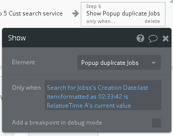

Actually I want to show a popup to the user that the request has already been received and he should wait 45-60 minutes before making a new request.
The plugin isn’t really designed for this use case and unless I have misunderstood you, I don’t think you need it for what you’re trying to do. You should be able to simply use current date/time. So your condition would be Only when … Current date/time - Search for Jobs’ last item’s creation date:formatted as minutes < 60
