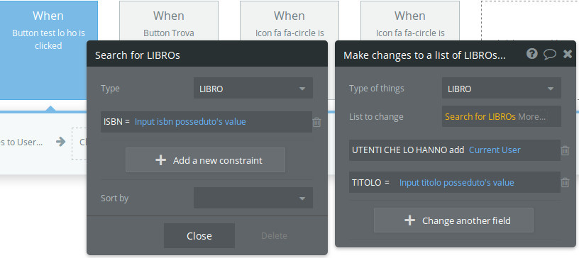

Hello @gf_wolfer thank for your attention first of all :slight_smile:
It is going better, but still not: let me explain as clear as possible:
I can not use make change to thing because the result of “the search for” is considered a list of thing so i get this error
I solved it using “change list of thing” and it works but there is no “create if the thing doesn’t exist” (first problem) so it just works if there is already an ITEM (LIBRO) with the same ISBN (ITEM NUMBER):
Regarding the second step of adding the item to the current user list of item I tried make “change to thing” user–>list of item–> add → result of step one. and I get this error:
So I tried user–>list of item–> add list → result of step one. no error message but it doesn’t work… nothing is added
I would really appreciate if you could help me understand.
Thanks!

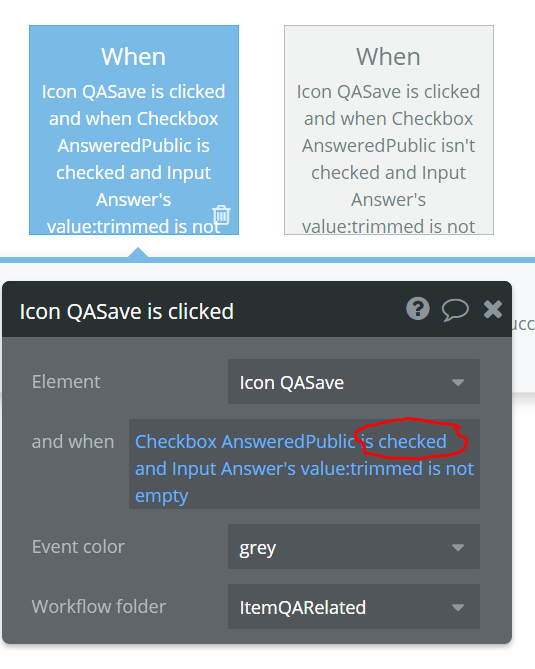

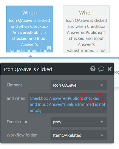

You set two different conditions for the same action in the workflow, for example, I have a save icon on a form, when it is clicked it depends whether a checkbox is checked or not as which workflow is run;
The workflow actions are then slightly different depending on which path is followed.
thanks @DaveA understood perfectly :wink:
