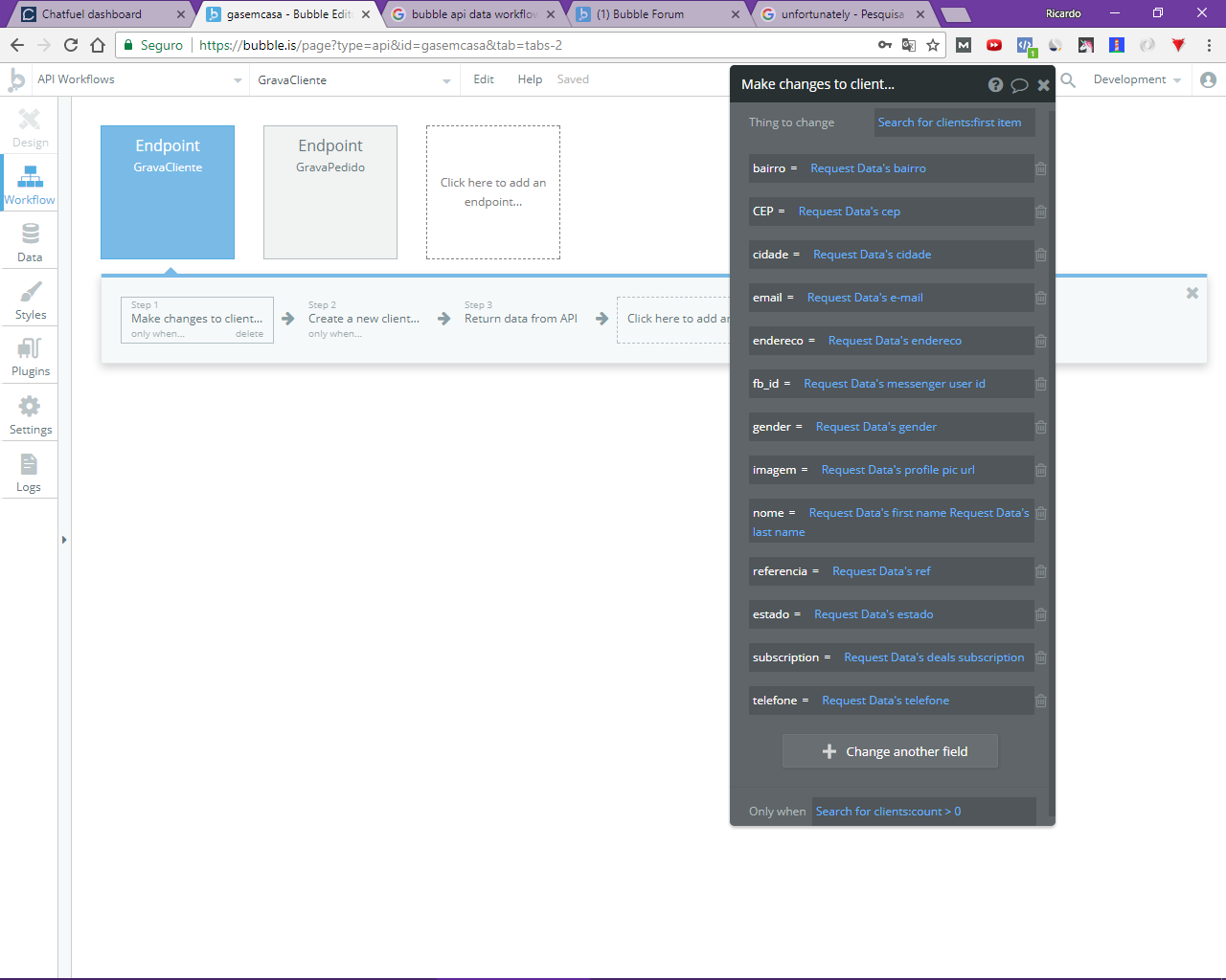

I have setup my wokflow as below:
Searching for clients->fb_id = request data’s messenger user id
Only when Search for Client:count>0
On the second step:
Only when Result of step 1’ is not empty

Hi @Kfawcett,
The workflow is not updating the Client table, it´s creating another thing.
Don’t know if the Only When Search for clients:count>0 is the proper way to do this.

I would remove the second step. The “Make changes to thing” should be the only step you need, if the thing doesn’t exist then it will create a new one in the same action if you check the “Create if the thing doesn’t exist”.

That’s odd. It should have the checkbox. I would open a ticket at https://bubble.io/bug_report
