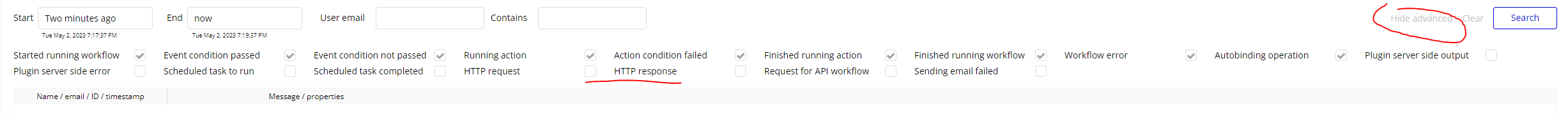

Tried it again (preview) and on free tier of PDF Monkey. Added HTTP Request/Response to Bubble’s server logging but don’t see anything appear there during testing.
