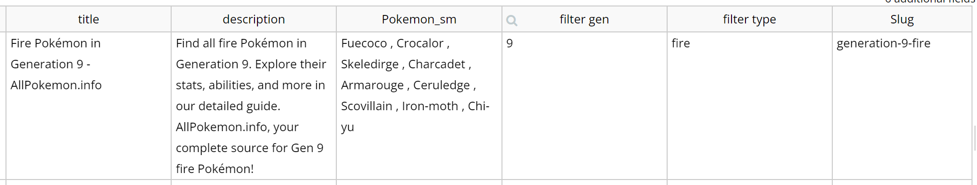

So I made a datatype called “Search” prefiltered there the list of Pokemon and added other important information.
An example of a “search” with a “filter gen” and “filter type”:
title = text
description = text
Pokemon_sm = List of Pokemon_sm (The datatype that contains the Pokemon information I need)
filter gen = generation
filter type = Option set: type
slug = text
I created the 189 combinations of filters (There are 9 generations and 18 types) and set their slug depending on the filters they have

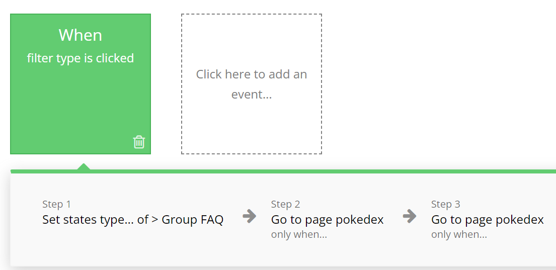

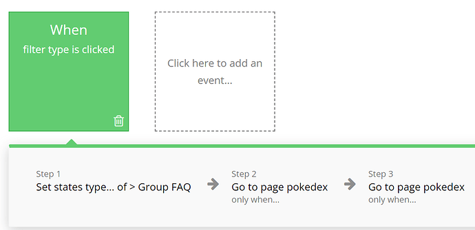

The frontend works by setting a custom state for filter gen and filter type depending the filter that is clicked
Here you can see
The first action sets the state of the filter
The second action is a “go to page” sending the “current cell’s search” and it has a condition that checks the “gen” custom state if is empty.
The third action is also"go to page" but using the custom state and the current cell to filter and find the right “search”
