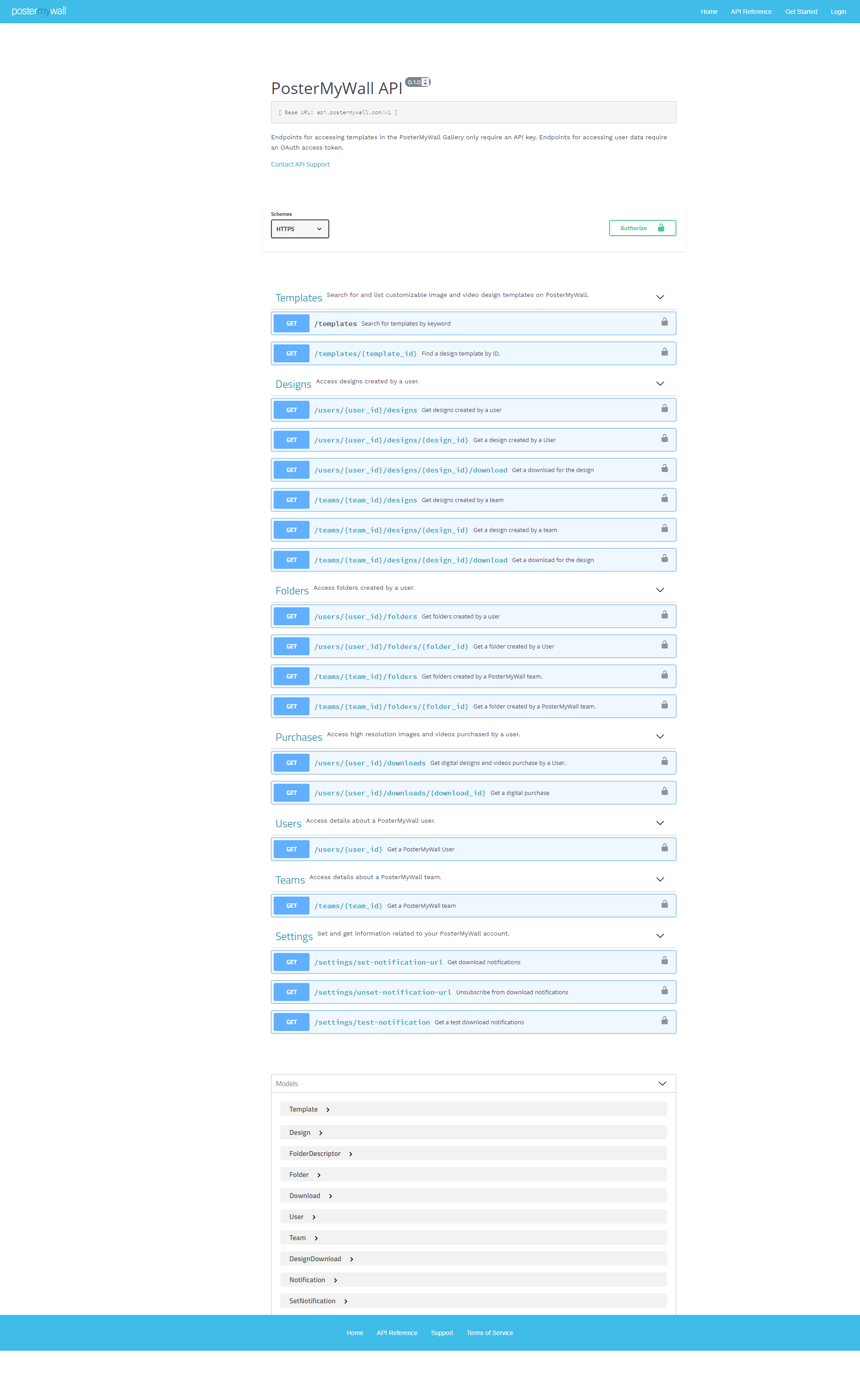

Thanks. I have found another Flyer website with a REST API feature. https://www.postermywall.com/
These are the links to the API documentation
https://developers.postermywall.com/api-reference
https://developers.postermywall.com/oauth-guide
https://developers.postermywall.com/apis/postermywall-api/index
How to proceed now? FYI, I’m not a developer and I’d like some help to make it usable within Bubble. How to do that? Thanks in advance.

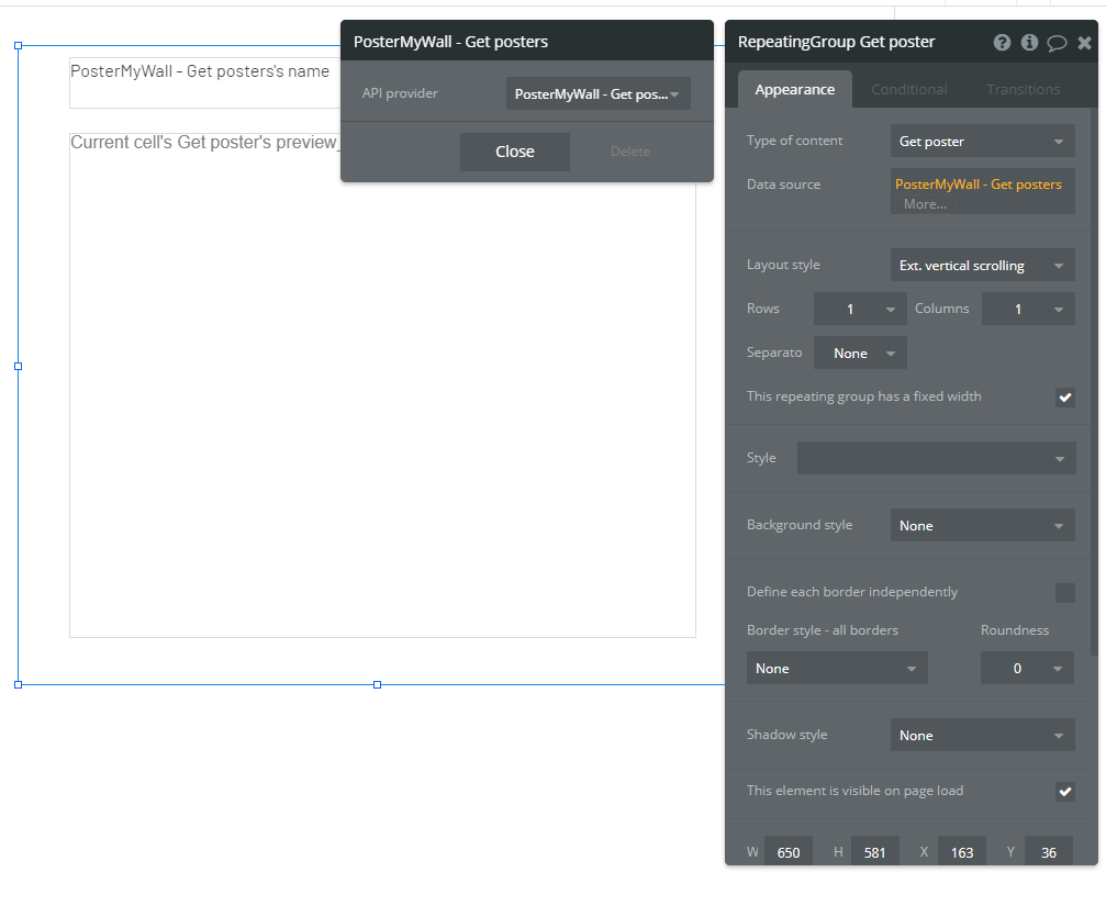

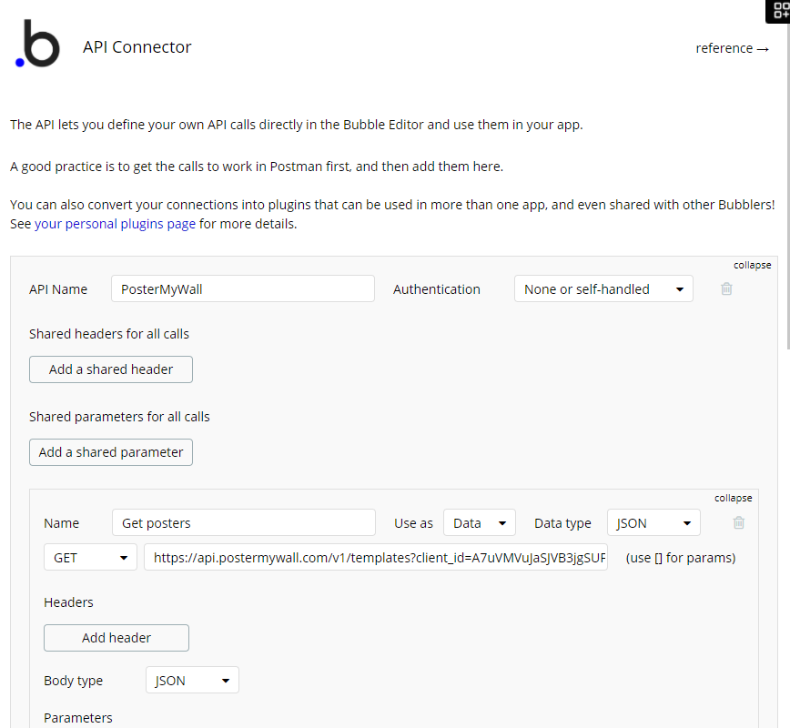

Just played around with postermywall’s API. They only allow you to pull data so it would only be of partial use for your use case:
Screen Recording 2020-12-04 at 10.58.43.19 AM
  • To connect to APIs the Bubble’s API CONNECTOR plugin is used
  • I created a free account in postermywall and created one test project. This creates an API key that is used for the GET call from Bubble’s API CONNECTOR plugin
  • This is the setup in the editor with one repeating group, one text element and one image element
Hope this provides some guidance on getting data from API services :+1:

Though after having spent times and tests on the API pages of PosterMyWall, it looks like I couldn’t get access to the Get/Design created … It looks like this part of the API is blocked except the Get Templates … Did you faced the same issue.
Anyway, Thanks so much for setting this up … I understand much better now how to connect a API with Bubble.
