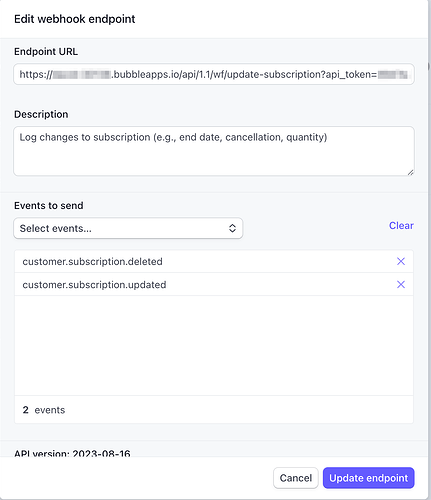

FWIW: I configure a single Stripe webhook and a single associated backend workflow to handle all the scenarios you cite.
Can you explain how to do that? THANK YOU!!
Do you use the “invoice” events in Stripe for those cases or a different events?
I configured the webhook for the customer.subscription.updated and ....deleted events, although I think just ...updated might suffice.
