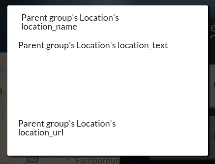

Here I am sending the marker that has been clicked to a popup, and showing the popup.
There popup has a type of location, but doesn’t have a source of data (you send that in with the action).
It would work as well (or maybe better) with a group box that is always shown with “selected location”.
