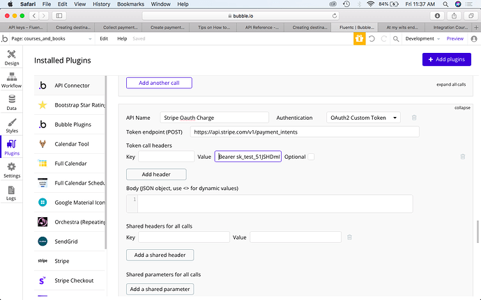

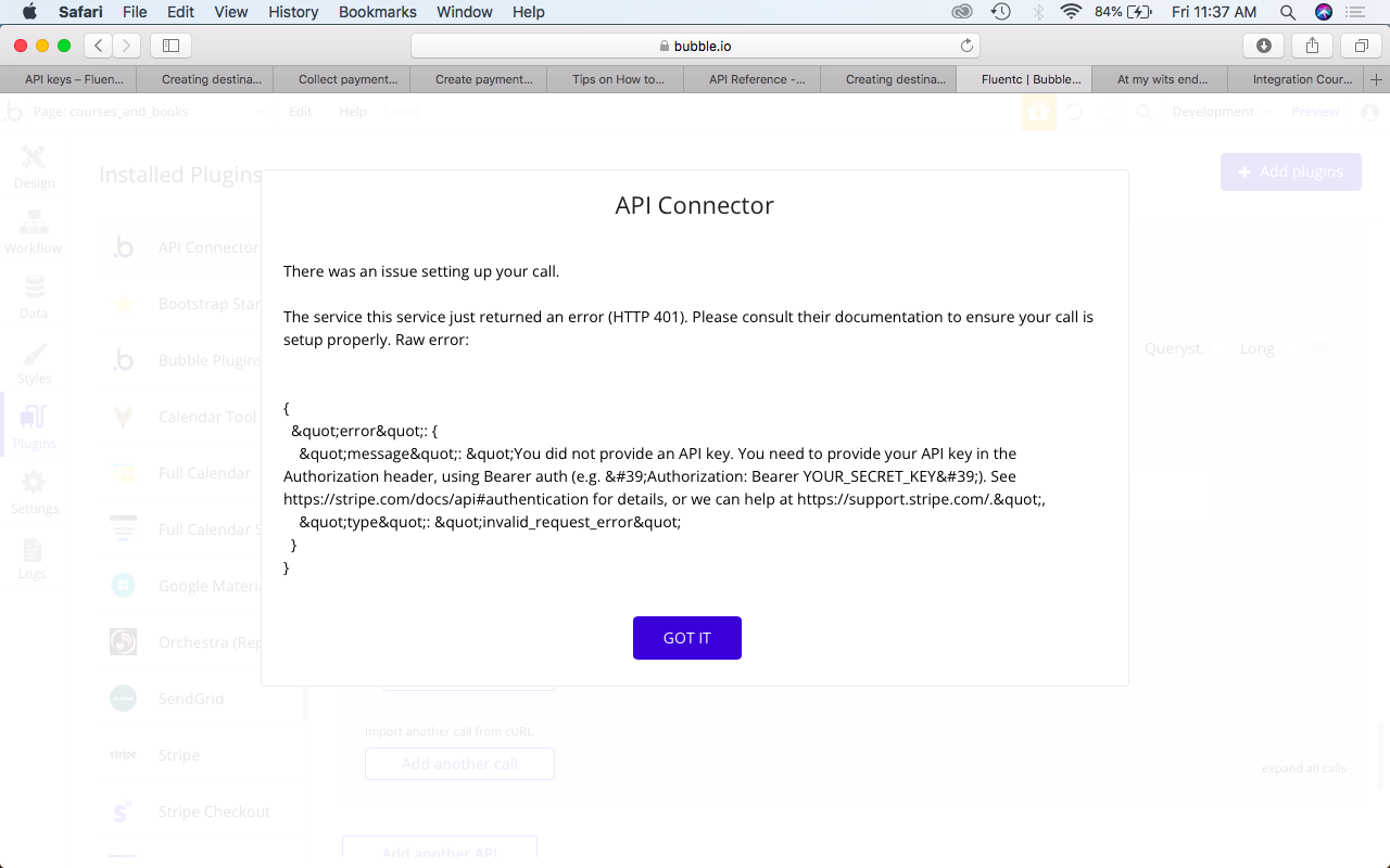

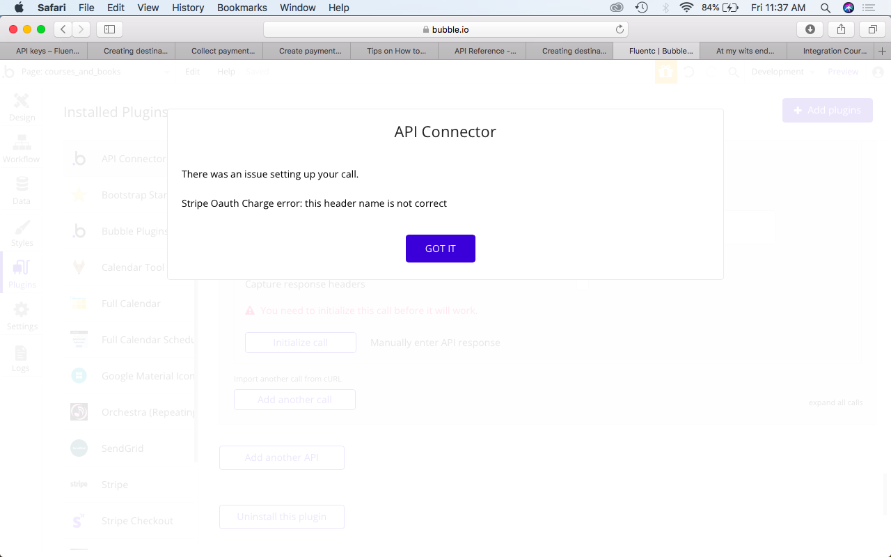

@boston85719 this course looks incredible and I’ve bookmarked it to return and follow up. However, I’m pushing myself to complete this Stripe integration and I have done most of the work but am stuck on one element I’m hoping you might know the quick resolution for.
I am using Oauth to create destination charge but the API call header key keeps returning an error. Do you know the correct call header key for this?
Please see attached screenshots.
Oh, one other question: Do you know the correct value to use for the transfer_data[destination] to achieve the flow of payment in the screenshot from Stripe here as well?
Thanks for any quick guidance you can provide before I take the course.
Hi @justin.schoenfelder1
Thanks for your kind words regarding the course. In the event you do take it, I hope you gain as much valuable insights as it is intended to provide.
In regards to the Header Key should be Stripe-Account and the value should be a stripe account id
The error you are getting is also associated with a need to be attempting a direct payment.
