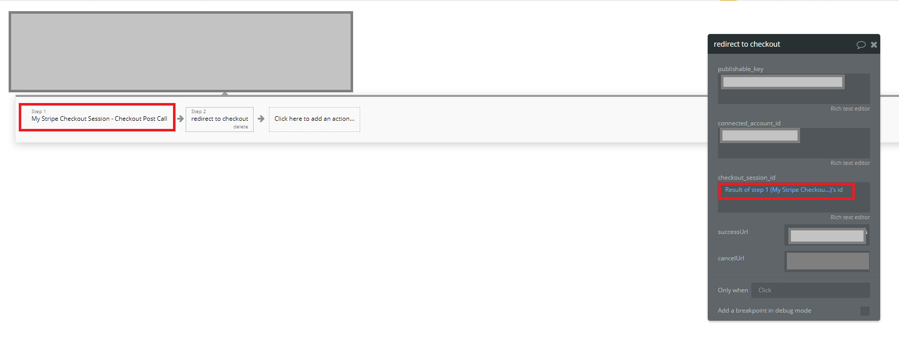

Hi @chris.anderson - sorry for the slow response. I built this specifically to be able to redirect to Stripe Checkout WITH STRIPE CONNECT. This is the critical piece - I believe there are other options if all you want to do is redirect to Stripe. I did not see any options that allowed me to use Connect and Checkout together. If this is not your use case, you probably can still use the plugin, as I made the ‘connected account ID’ optional.
I’m not sure exactly where you’re hitting a snag, but I’ll try to explain how I used it in my app:
  1. You need a Stripe Checkout session first, before redirecting. I did this using my own API (in Bubble’s API connector)
    In this call, you define all the parameters you can see above - you can feel free to copy this if you would like!
  2. In the workflow where you want to redirect to checkout, first you use this API to create the Checkout Session. Then in the next step in the workflow you can use the plugin to redirect.
    Make sure you use the Checkout Session ID that was the result of the previous step.
That’s pretty much it! Let me know how that goes–
Jake

So my question is from a Bubble Workflow point of view, where does this all fit in? Are you able to share your workflow or critique the following please? Would I be correct in assuming it’s something like this:
  1. Click on dedicated amount button (step 2 in the use case above)
  2. Post API call to get Stripe Checkout Session
  3. Use your plugin to redirect to Check out page using the connected account from the seller’s profile page, the checkout session from step 2 in this work flow and end up on payment page (ie.e Take the Customer to the page described in step 3 in the use case above)
  4. Where do I set the amount? Does your “Redirect to checkout” go straight to the checkout page or us there another step before this, like “Charge Customer” in the Stripe plugin?

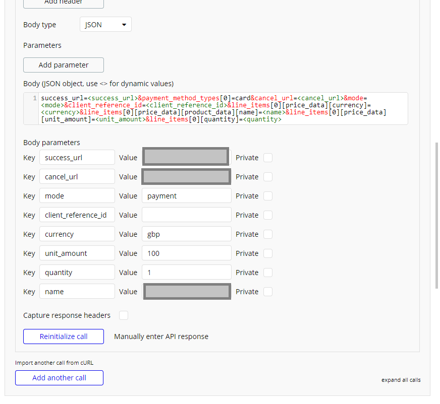

Thanks @jakesing! Again, much appreciated. I’ve made some good progress and ended up getting deep into the Stripe docs, although there is a gap between what Stripe needs to work (based on actual coding languages) and applying this to Bubble logic, I think I’ve straddled this enough to get to the next step. However, it looks like I need to work on my “Payment Intent” logic next - @jaredg looks like you’re getting on well with splitting the payment and we have a similar one-off payment use case… Any advice or JSON body you can share please?
In case anyone else finds the initial setup useful, I’ve screenshotted my API call to create the Checkout Session (I’ve hidden my keys and data - if you spot something I shouldn’t be sharing, please tell me):
Don’t forget to add "Bearer " before your key (No need for quote marks but you do need the space).
In order to initialise the call, you will need to put values in. I’ve put grey blocks over these to hide my data but you can enter your own to initialise and then set these dynamically later in your app.
My code snippet is here for easy copy and pasting which I created based on Stripe documentation, here: Accept a payment | Stripe Documentation. NOTE: I’ve configured this call to create the PRODUCT and the PRICE in-line with the session creation rather than creating them in advance within Stripe. I’ve also not been able to test this fully (see issue at the bottom) but it at least gets your far enough to initilise a call and use in your workflow before continuing to use Jake’s plugin:
success_url=<success_url>&payment_method_types[0]=card&cancel_url=<cancel_url>&mode=&client_reference_id=<client_reference_id>&line_items[0][price_data][currency]=&line_items[0][price_data][product_data][name]=&line_items[0][price_data][unit_amount]=<unit_amount>&line_items[0][quantity]=

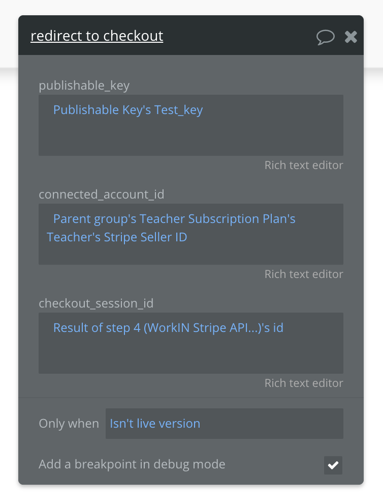

However, I’m now having the same issue as @jaredg:
To help debug / check if it’s the plugin or user error, here is my other setup:

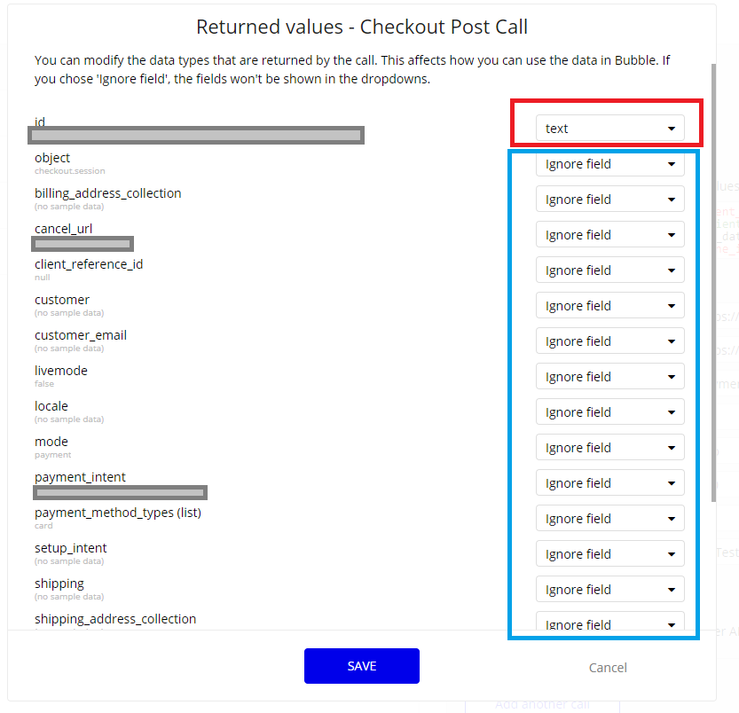

In the workflow I’m only passing in the ID of the result from Step 1 as per your screenshot. Step 1 is my own API call to get the Checkout Session.
I also tried to mitigate this further by ignoring everything else in the response apart from the ID, when I initialised the call (I don’t know if was correct or not):
However, I’m now unable to proceed past this point now. Can anyone help or suggest what I’ve done wrong please?
Hi Jared,
I thought I had reverted back to the version before adding in successURL and cancelURL, since you are right, the redirect call does not need to include it (I think I was tinkering with something at the time, but I don’t remember what specifically).
I will re-revert back to version 1.1.0, I do not think there’s any need for those fields.

Thanks for the detail on the code snippet for the API call. There are so many use cases with Stripe, I can see how this list of fields would be hard to keep up with. What I got to work was reverting to 1.1.0 (the new version 1.3.0 seems to be working though now… thanks Jake!) and creating the products/prices in Stripe ahead of time and putting the price ID in my workflow for the API call. But I would much prefer to create the prices and products on the fly and not have to keep a separate product database in Stripe.
Here’s what I was using with predefined products in Stripe (<price_id>):
success_url=<success_url>&payment_method_types[0]=card&cancel_url=<cancel_url>&line_items[0][price]=<price_id>&line_items[0][quantity]=<quantity>&mode=payment&client_reference_id=<client_reference_id>&payment_intent_data[application_fee_amount]=<platform_fee>
And after your helpful info, here’s what I’ll use now:
success_url=<success_url>&payment_method_types[0]=card&cancel_url=<cancel_url>&line_items[0][quantity]=<quantity>&mode=payment&client_reference_id=<client_reference_id>&payment_intent_data[application_fee_amount]=<platform_fee>&line_items[0][price_data][currency]=<currency>&line_items[0][price_data][product_data][name]=<product_name>&line_items[0][price_data][unit_amount]=<unit_amount>&line_items[0][price_data][product_data][description]=<product_description>&line_items[0][price_data][product_data][image][0]=https:<product_image>
The other thing I noticed is that the payment_intent_data.platform_fee amount must be an integer. No decimals. It’s not a percentage. (same thing for the unit_amount). So if you want to charge your stripe connect seller $1.50 USD, you would enter 150 for the value. Here’s how I did that on my API workflow call to calculate a 15% fee for example:
