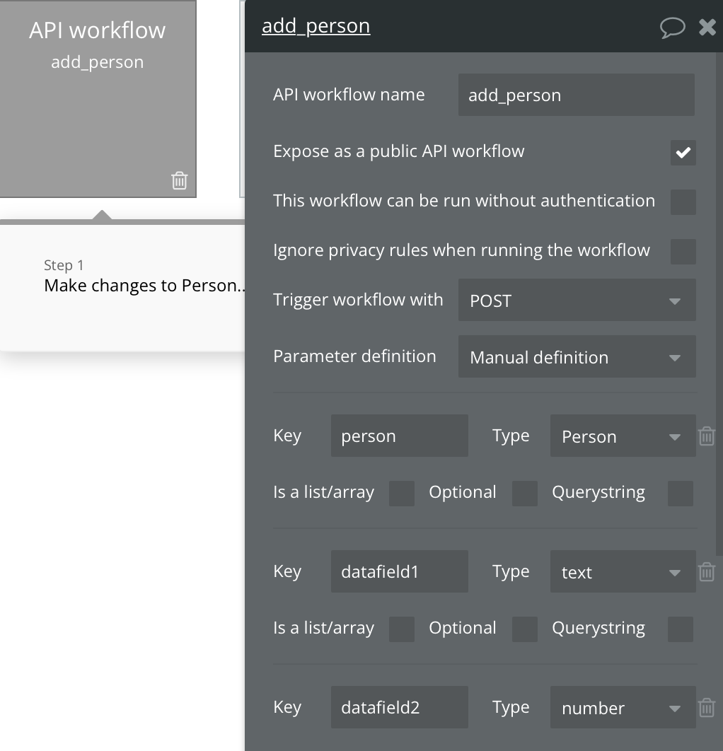

First create a backend API workflow. You should add a Manual Definition parameter of “person” and type of your Data Type you are saving / uploading from CSV.
In that workflow you are going to want to have one step which is “Make changes to a thing…” The thing you are going to change is the person defined in the previous screen (the person passed into this workflow). This is where you are setting your additional data columns.

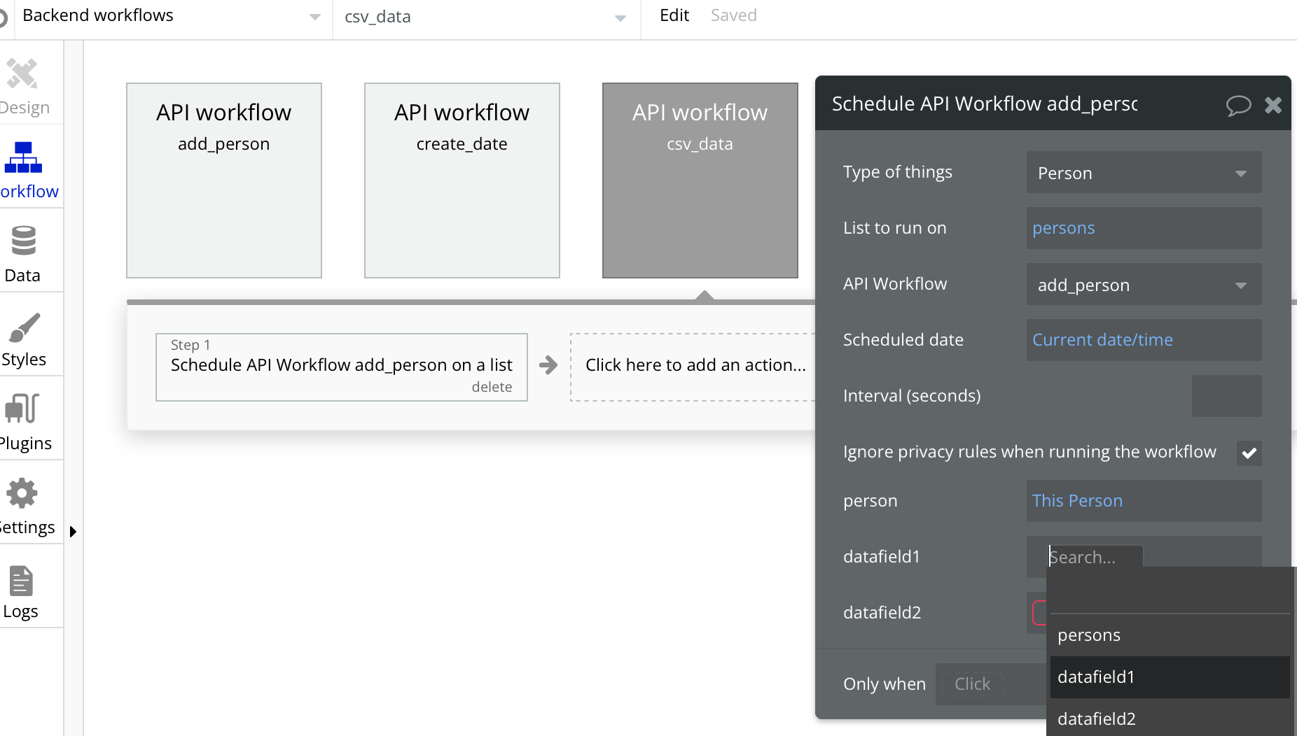

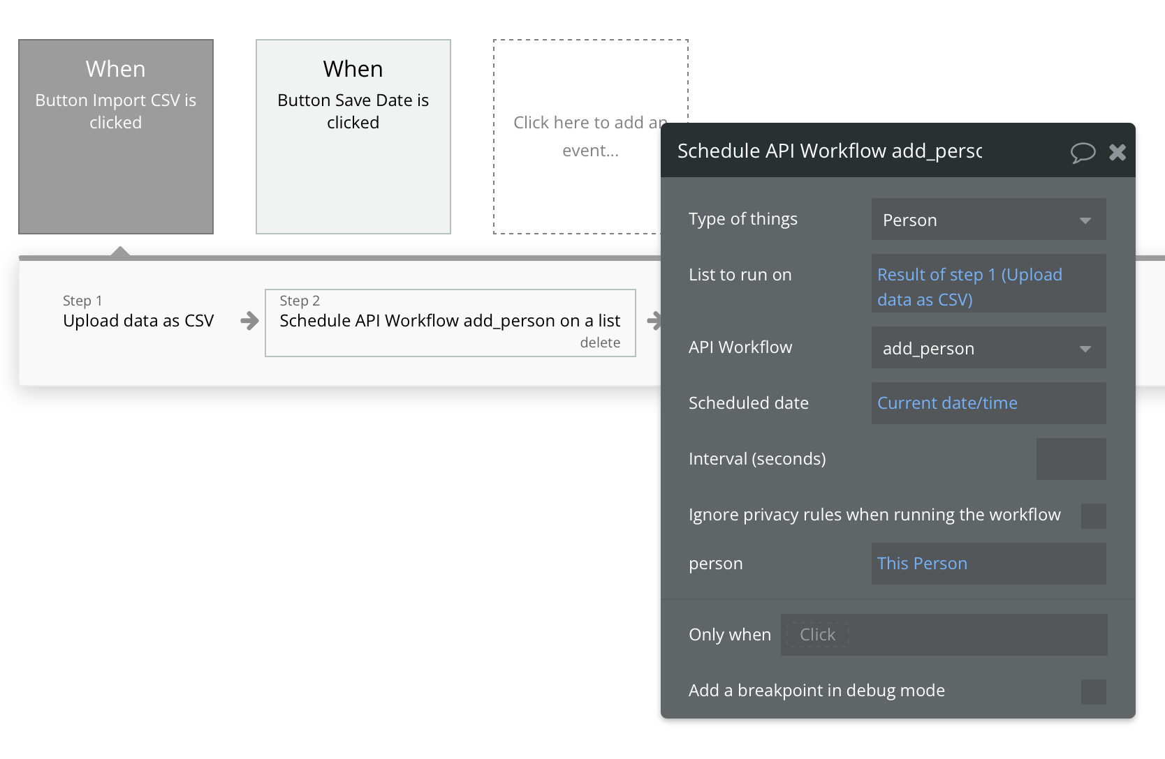

Finally, connect this workflow with your CSV data uploaded in the next action. Here you will “Schedule API Workflow on a list”. The list is the result of step 1 (which is your uploaded data) and you are going to pass in “This Person” which is a reference to the list above defined by List to run on…

Fair enough, I figured you might piece together the details but I probably should have just connected the remaining dots. When moving between a page workflow and a backend workflow you must pass all of the data you are going to need from the page workflow to the backend workflow via additional parameters.
On the page workflow you will be able to get data from the inputs. See below:
datafield1 and datafield2 are now available in the “Make changes to a thing…” because they are passed in via workflow parameters:
Workflow additional parameters:
Workflow additional parameters on the “Schedule API Workflow on a list…”
Example of passing inputs from the page (ddlDay/ddlMonth/ddlYear) into the API workflow parameters defined above.
This connects all of the dots. If this doesn’t make sense to you I would suggest reviewing the documentation further or watching a few videos on Bubble workflows.
