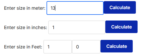

I have 3 input text fields namely “Mtr”, “Inches”, “Feet”. I want user to enter one of the input field and then press a “calculate” button against each text field
When I give input in “Mtr” and press “Calculate” the values of “Inches” and “Feet” should be set to zero value and they are working fine.
Once I manually typed a number in the Input text I am unable to reset its value to zero using Set State. Any reason why the setstate in the input text doesnt work once I manually typed some value in it?

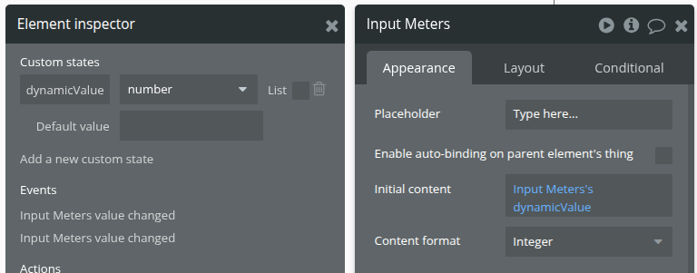

This is the setup that I use for dynamic setting of inputs.

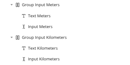

  1. Input elements, inside respective Groups
  2. One custom state per Input element
  3. Initial content of each Input element set its own custom state value

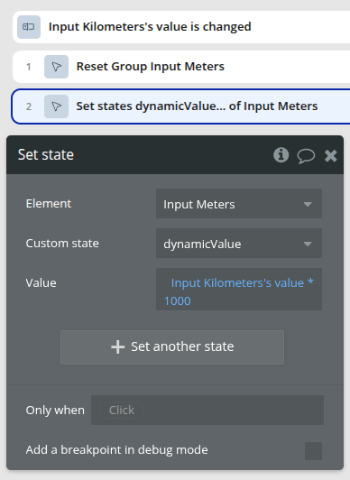

  4. On Input value is change, reset other Input elements’ Groups and set their custom states

  1. press Enter with the new value
  2. execute Reset Group Input A action
  3. set custom state of Input A element
  4. ensure the Initial value of Input A element is set to its own custom state
it works.
You might have skipped some step

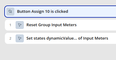

Understood and reproduced.
But once again
You can’t expect the value to change if you ONLY set the custom state with Set state action.
You NEED to reset the input by using a Reset Group action AND then set the custom state with a Set state action.

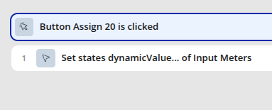

This WON’T work
This WILL work
