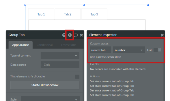

hehe thanks anyway. Is there an easy way to see a list of all the states that you have created?
Yes! With the (fairly new) element inspector. Click the “i” in the property inspector.
Brilliant thank you @romanmg your a star love this community :smile:
