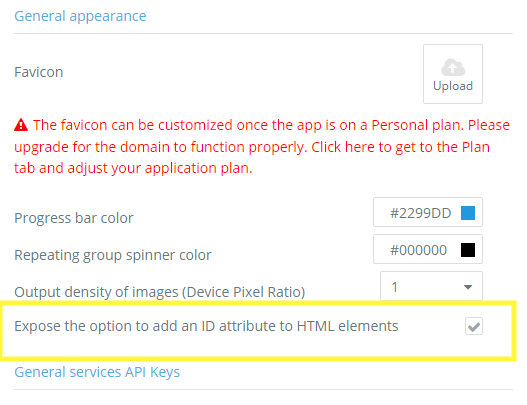

Hey @amar.sehic,
Go to Settings > General > General Appearance > Check “Expose the option to add an ID attribute to HTML elements”
Then at the very bottom of the property editor for the HTML element, you’ll see a new option for “ID Attribute”. Enter “street-view” there and remove the div from your code. Meaning, just have the code inside your script tags.
That should do it.
is-2017-11-02-09-56-00-075
Property Editor:
is-2017-11-02-09-56-31-863
