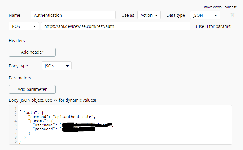

When I try to initialize the authorization API it returns
Raw response for the API
Status code 401
Authentication session is invalid: Error: Both username and password required.
Also Tried
