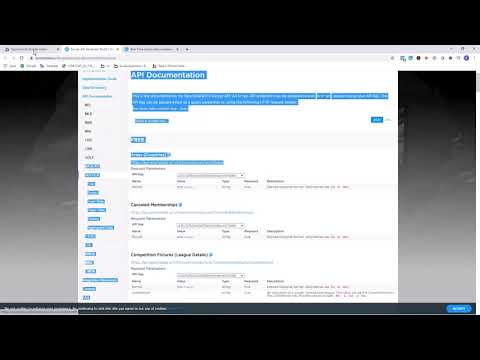

@ed727
These videos by @evanlitttle are pretty straightforward and shorter than the Bubble webinars
There is also a bunch of very knowledgeable folks @neilpierce @mariel.vargas that are cranking up a new community/service to learn and obtain support on apis and Bubble > https://nocodeapis.com/
@ed727
Calling functions (endpoints) within an app is not an uncommon practice.
Thanks for this and the video. Yes, I need to take the plunge at some point and learn all the API stuff…
