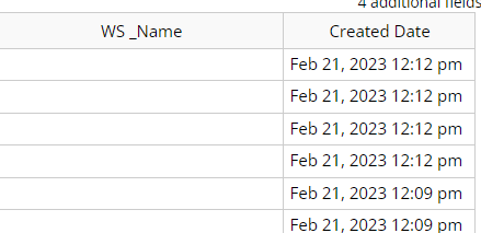

what am i doing wrong? I tried switching to POST, but to no result… sorry for a noob question.
What exactly is not working?
Are the options correct? Still not giving names to the things…
Are you passing a valid text value into the workflow parameter?
Yep, double and tripple checked it. Thank you for your time though!
Well, if you are then it should be working.
The fact it’s not means you’re almost certainly not passing a valid value into the backend workflow.
But you can check your server logs to see for certain.
Sorry for wasting your time, yes , now i solved the issue. I didn’t specify ws_name in the workflow on the page itself… Thank you for your input on the forum!
